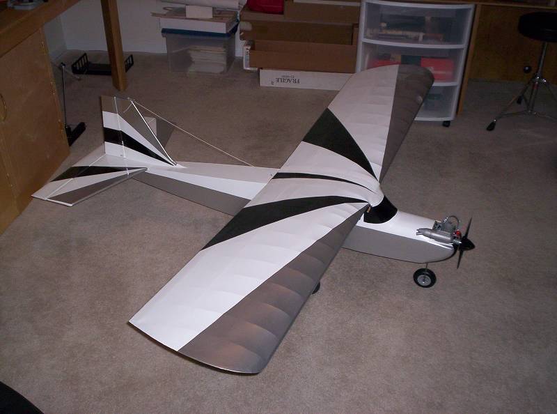

Good morning all! I've finally finished my Sig Kadet Senior, I've got my AMA membership, and I'm taking it to the local club here in Charlotte,NC today to let the experienced pilots look over my blood-sweat-and-tears to make sure it's air worthy, and let them make the maiden flight before I begin my instruction (wish me luck).
Here is my question... I have a Futaba T6YG Skyport 6 and I'm using the receiver and servos that came with it in the Kadet Senior... I have allready started construction on my second plane (Top Flight Contender) and I'm about 80% done prior to the covering stage and I'm planning on purchasing a filght pack now to go in the Contender. Using my Skyport 6 as my main radio, does it matter what reciever/servo combo I use, as long as it has a crystal that matches the frequency of the radio, or is there more to it than that.
Also, are the Hitec HS-425BB servos as good as the Futaba S3004?
