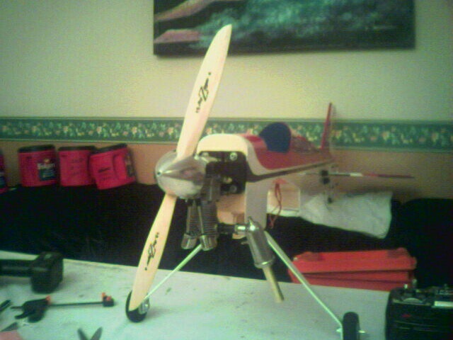

I have installed a Saito FA 82a in my UCD .46. I have it broken-in and tuned, on the ground anyway. It will be time to maiden and install the cowl soon, if the rain lets up long enough. I have some questions for the experienced 4-stroke guys.
1) The engine is inverted and the vent line is coming out the 'top', (I have a long tube connected to it running it down behind the engine). How do I rout the vent line out of the cowl and keep it short, the mfg says 3" or less....
2) How large should the cowl vent be in order to allow proper cooling. I am running 10% to 15% glow fuel. I have heard that a smaller vent slows down the air and allows better cooling, but I don't want to cook the thing.
3) I have heard that a clogged or long vent line could lead to high pressure inside the crankcase which could blow out bearings or crack the case, has anyone else heard of this?
Thanks!!

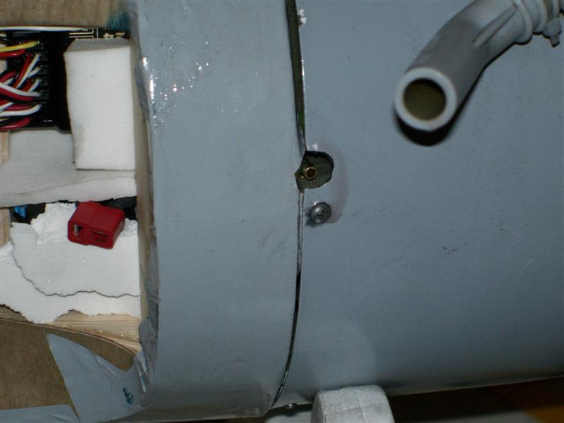

as far as the line glue a piece of brass tube to the firewall sticking about an 1/8 inch out the cowl

as far as the cowl opening for cooling the bigger the better, as rule of thumb the out hole should be at least 3 times bigger than the inlet, i will post a pic of mine at bottom.

With the case vent line just barely sticking out the cowl it may cause a lot of oil blowing on the fuselage.
This is ok if you don't mind more cleaning.
What I do is use medium fuel line from the case vent to just exit the cowl connected to inside of larger fuel line. I then run the larger line down the landing gear to exit just behind one of the wheels. The case vents just fine, no presure build up and the plane stays a little cleaner.

After much consternation I put a 14x4W prop on it. Any better ideas? (Remember, I am a beginner). Only 10 gallons thru my planes, including solo).
