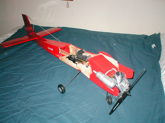

I have brought my Falcon III out from the cellar and I am going to attempt to finish.
Here are some photos of where I have stopped construction.
I am building it as a 3-channel instead of the 4 (I have to order some replacement aileron stock as I messed up my attempt at ailerons) so as soon as the order comes in I can just glue it in place at the trailing edge as the center pieces of the trailing edge are already glued in place and I am not ripping them off to add ailerons.
I am going to use a fixed landing gear as pictured instead of the wire that was originally with the kit, don't think it will affect it in any way as it brings the plane to the same height. And I am using 2.50 wheels instead of the instructed 2.25
I am going to cover it with white Sig AeroKote film http://www2.towerhobbies.com/cgi-bin...XJAU0&P=K#tech with blue graphics (more than likely stars). Has anyone used this covering and with what results?
I am going to power it with a .36 engine with 6 oz tank. The instructions say to glue the tank inside of the fuselage with no access to it, but I have changed that to include a hatch at the bottom of the fuselage.

The original Goldberg Falcons were the staple for trainers back in the 70s and 80s. I have nothing but praise for them. You will be using an instructor, won't you? I would build it with ailerons. However, the airplane will likely do fine with rudder instead.
Posts: 8
From: Kingston,
ON, CANADA
Hi I would take the time and add two servo bays in the wing for ailerons. That way you would have the option of opening them up and installing your ailerons at a later date .You would not have to remove the aileron stock in the centre of the wing just make wholes in the centre ribs for your servo wires. A sharp piece of brass tubing will do this nicely.This would allow you to sell it easier as well. always leave your options open as you never know what tomorrow might bring.I fly all planes and enjoy the challenge of R.E.M. the most.Also if you are flying with R.E.M. increase the dihedral in the wing if your controls feal sluggish.Enjoy STUFF
My Feedback: (13)
in 1978 I had a falcon 56 great trainer, agree with the posters above you should think about ailerons, as this plane will be a floater, and easy to get blown arround all over the place also helps with your landing aproaches unless you have a wide landing strip you might be sorry without them. there are not to many trainers of this size without them . back in the day in78 the kit wasn't an arf and had skinny ailerons after my first flt the instructor sent me home to extend them they were 3/4" and had no effect and after doubling that it was alot easer to fly for sure and alot more fun, the falcon gave me alot of fun flying time it was a great first RC kit

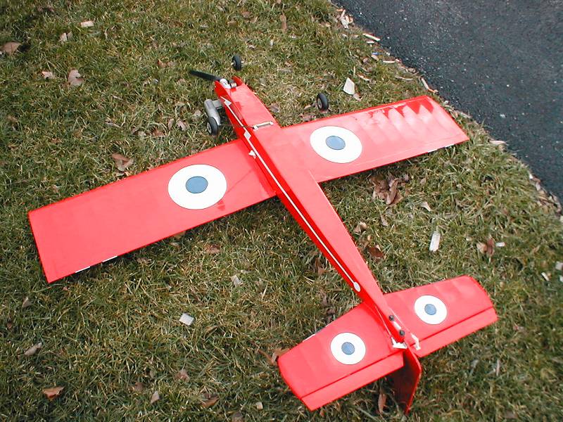

1st - No, Ken, that is not a Falcon in the pic. Here is a pic of the Goldberg Falcon III
Here is the Goldberg Falcon 56 Mk. II
