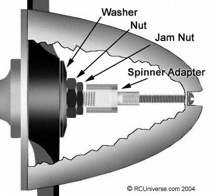

Also I have a spinner with one bolt that goes down the centre of it, How do you attach the spinner correctly? What bits go on first etc...

Counter Clockwise as you look at the engine from the front, or Clockwise if you were sitting in the cockpit.
You need a spinner adapter nut to put that type of spinner on
