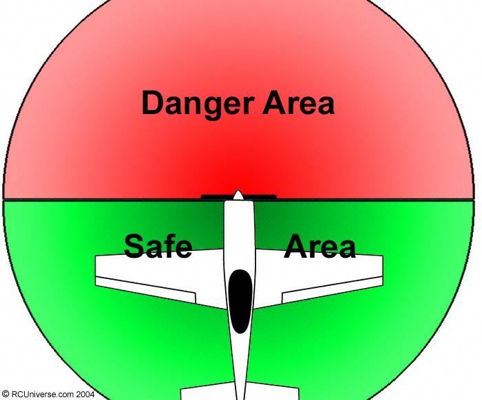

ORIGINAL: BANJOAIRPLANE
Try and put the sun at the rear of your plane and take a reading from front, or sun at the front of the plane and read from rear
NEVER take a tach reading or do ANY type of engine adjusting FROM THE FRONT!
Absolutely. NEVER EVER do anything in the front or the sides of a running motor. Props can and do break or come off. You don't want to be in the path of one that gets thrown. Always stay away behind a running motor. See attached diagram.
First thing on the tach is to test it to make sure it is working properly. Turn it on to the two blade setting and point it at a fluorescent light, it should read 3,600 RPM. The reading may differ, but the reading should be a multiple of 60 (this is because your electricity runs at 60 hertz and a fluorescent light actually "flashes" on and off with the electricity. And yes, other countries run their electrical current at 50 hertz). If the tach is working properly then you should do as stated above. Take the reading from behind the prop, and try to have the sun on the other side of the prop.
Hope this helps
Ken

Old 05-09-2006 | 07:33 AM

Don't be a smartA, BANJO. If you've ever been in the area of a flying prop or a runaway plane, you wouldn't make jokes. Although you DO need to be in the danger zone to start the plane, REALLY smart pilots quickly move to the rear to do any adjustments.
However, if your engine will start with a chicken stick, and you can reach the prop around the fuselage/cowling, the engine CAN be started from the rear.
Also, several years back, a device was developed that held an electric starter in place in a stand. The pilot held the plane with the spinner pressed into the starter cone, and the starter was triggered with a footswitch.
