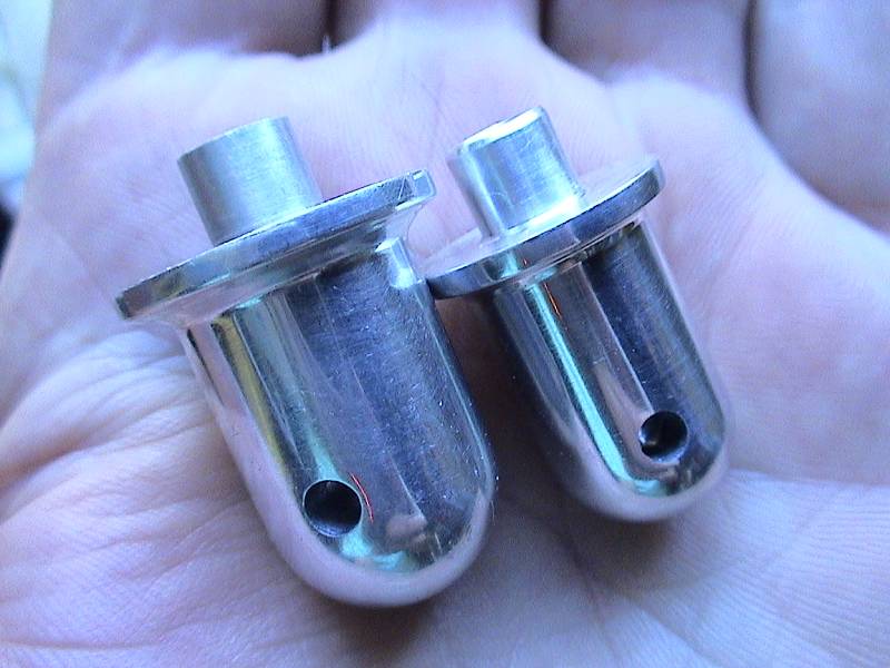

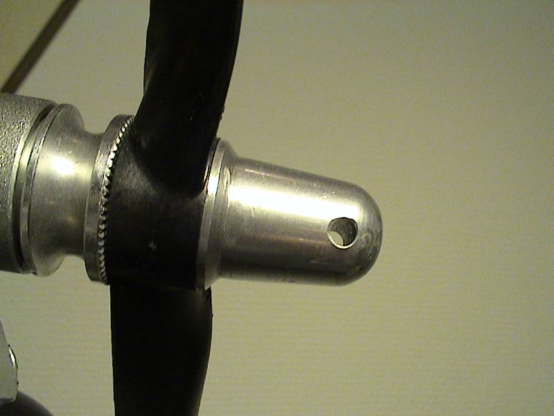

Posts: 7,816
Received 10 Likes on 10 Posts
From: Upplands Vasby, SWEDEN
Default RE: Do I need a spinner ?
Hi!
Newcomers should stay away from spinners...at least from cheap plastic ones.
Tru Turn aluminum spinners are OK but for a newcomer it's overkill.
A much better solution for both newcomer and adwanced fliers is to use a aluminum spinner nut.
Regards!
Jan K
Sweden
