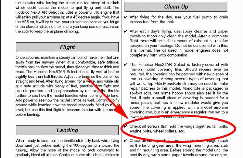

As far as the screws go. Here is the break-in procedures (and continued maintenance) that should be taken on every plane, no matter if it's a kit, ARF, or RTF. The plane needs to be assembled and every screw, nut, bolt, clevis, etc... needs to be tightened. This means everything on the plane. If you break-in the engine on the plane then everything should be checked again to make sure it's all still tight. This is especially true for the engine, check everything to make sure it's still tight (including the head bolts because they can and do loosen up on break-in). After your first flight it's time to recheck them all again. After that you need to set up a maintenance routine of how often you check them all again. Some do it a couple time a summer, some do it a few times a month, some do it after every day at the field. Myself, I check everything as I'm cleaning up the plane. If I find anything loose I'll bring the plane into the shop when I get home and go over it all again to see if anything else loosened up.
These planes aren't fly and forget. You have to check them to make sure everything is still tight on them. I've seen pilots that have planes that are 10-15 (and more) years old, and if you ask them I'm willing to bet that every one of them have a routine of checking their plane over.

ORIGINAL: krosypal
ORIGINAL: bruce88123
IMO this would be basicly trying to swindle Tower for a minor problem of neglect. If you want to complain to anyone, call OS. just because nobody at your field checks their equipment for loose hardware, at least to your knowledge, doesn't make the mfg responsible.
No one here was aware reporting loose screws on a RTF package was considered swindling. OS isn't responsible for plane damage. 6 flights in one day isn't neglect in my opinion.
As myself and others have mentioned, it's not Tower/Hobbico's fault if a screw comes loose. To ask them to replace an item because of user neglect is totally out of line. As was said above, it raises the prices for all of us in the hobby. A corporation like Hobbico isn't going to just "eat" the cost of that replacement, they will figure that into the cost of all items that are sold.
Even though the Nexstar is sold as an RTF package, the instructions for that plane clearly point out that the plane should be checked for loose bolts, screws, etc.... while you are cleaning up the plane. Here is a link to the Nexstar manual online [link]http://www.hobbiconexstar.com/downloads/hcaa17-manual-v1_1.pdf[/link] , the portion of the manual that I am referring to can be found on page 23 of the manual under the "Clean Up" section. Here is a screen shot of that portion of the manual.
I am not trying to say that Dorsil is wrong, and I do understand why he would want for this discussion to end. But I have a hard time sitting quiet when something like this comes up. It's just not the manufacturers role to replace items damaged because of neglect. Should we ask them to replace a plane because we only put 4 rubber bands on the wing?? Because we didn't fully tighten the prop down?? Because we didn't put a full tank of fuel in?? Because we didn't charge the radio batteries before we flew?? Of course not. Asking them to replace a plane because of a loose screw is the same thing.
