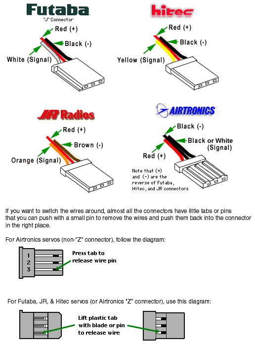

Here is a wiring diagram that will show you the proper wiring for all the major brands. This shows the servos, but you can translate that to your receiver.
Hope this helps
Ken

Thanks for the replies, yes the signal wire does go to the inside.
flynte
