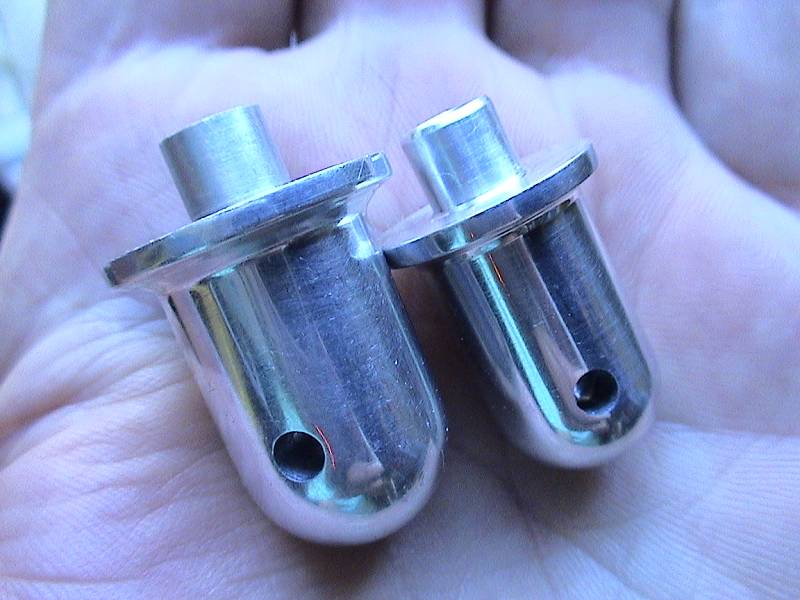

As you use a 7,5cc engine (.46) the correct 3-blade prop is a 10x5 or 10x6...Not a 11x7 or 9x6.
As for fixing the too large hole...one metod is to turn a aluminium spinner nut like the one I have in the picture (Can make it for you) or find a brass (K&S) tubing that could act as a spacer. Do not fill the hole with a dowel or wind tape around the axle....[8D].

Nothing like blowing your own (prop nut) horn while you're at it, jaka. I've filled many props with HARWOOD dowel, and the method works well. Drill the prop hole just undersize for the dowel and tap it in place. Soak the front and back with thin CA, sand flat, and carefully redrill with a bit that makes a snug fit on the crankshaft.
