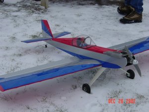

Posts: 1,860
From: Weirton,
WV
Here is a picture of my 4 star 40 that DSJBEAN (Doug Johnston) built for me. He increased the control surfaces by about 5/8" and added dual aileron servos. He also added some triangle stock to the tail and du-bro fiberglass landing gear is used. Maybe he could reply to this post and mention any other mods he made to the plane. The plane is an amazing flyer.
Mike

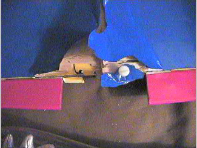

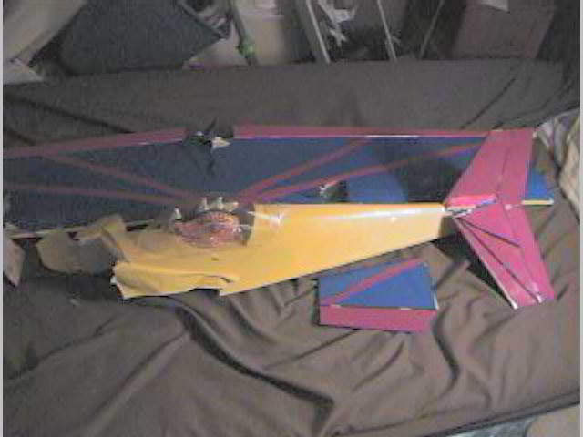

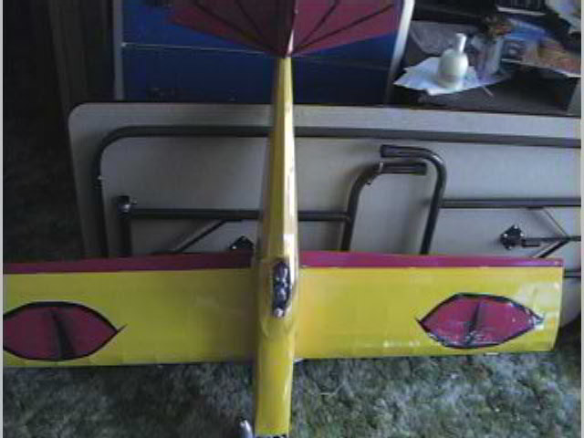

Posts: 79
From: Wolf Point, MT
I don't know if anyone has had this happen to them, but my first 4* 40 I built with the help of an experienced builder, spent months on it to be sure it was straight and well balanced. On it's maiden flight, I had the more experienced pilot fly her, she lifted off the ground, got buffeted by the wind slightly, then banked to the left, the pilot yelled "I have no control" and the plane slammed into the ground. Upon checking the wreck, we found nothing wrong with the radio or equipment (range check, servo throws and directions, along with many other preflights were done) the thing that we decided may have happened is, according to the directions and the plans, the wing hold down plate is really not on anything solid (except for a bit on the trailing edge and on the center), so a little pressure could cause the wing hold down plate to break through the covering. I must have tightened the bolts too tight one time and weakened the covering and the wind may have busted the wing hold down plate through the wing. Now I don't know for sure if this is what happened but when looking at the plane, one wing hold down plate was attached to the fuselage (like it pulled through) and the other attached to the wing. Just in case, I had the complete plane and mechanics checked by a professional builder and sent in the radio, servos, batteries etc. to airtronics to have them fully tested and they were in great working order.
Has this happened to anyone else flying a four star.
I am definitely going to build another and make sure that the wing hold down area is strong.
I have seen someone flying this plane, have the main landing gear shift (didn't tighten bolts well enough) and be able to slow the plane so much as to have it settle into the grass at practically no velocity and not damage a thing.
here is my before picture
