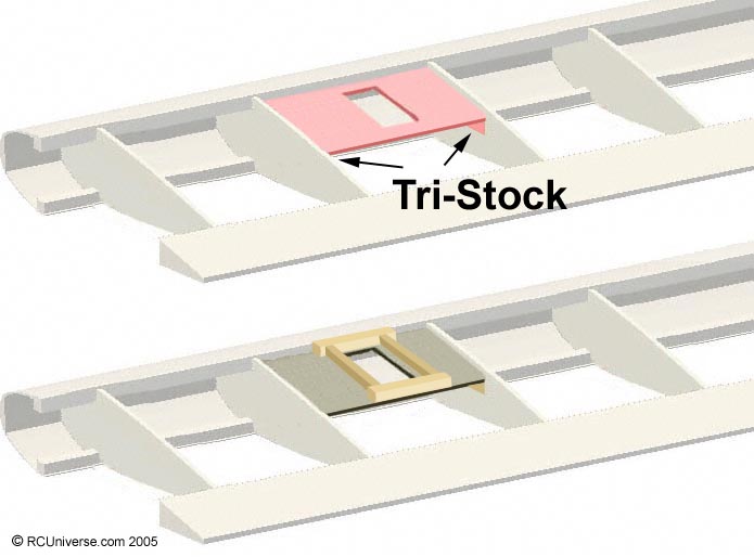

Does anyone know if the Hanger 9 Arrow has servo bays installed if you wanted to go with 2 aileron servos? I have reviewed their manual on line and there is no mention of this option. I will buy this pane if it has that option already built in. My Nexstar is about worn out and I want a semi symetrical high wing plane to play with. Thanks

If your not afraid of modifying it then it really does not matter. Build some bays in it. Use your nexstar's bays as a starting point.

I don't believe the Arrow has bays as part of the standard wing but as said before it would not be difficult to modify for this. Be sure to do the mod before joining the wing to make routing the wiring easier. You may need to cut holes to route the wing servo wiring. This is MUCH easier before wing joining.

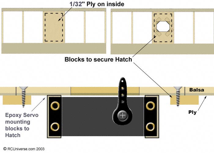

Here are a few pictures to help you see different ways of putting in a servo bay in the wing.
Hope these help
Ken

In stock form, the Arrow does not have two bays for aileron servos. You will have to build a second bay to accomodate the separate servo. This is not difficult, and you can use any of the techniques already mentioned.

I did the duel servos on mine took all of 20 mins just make a templete of the one thats on it cut one out of ply then mount it right next to the one that's there
trim out the balsa and mount the servo hook up the linkage and your done it will still fit inside the fuselage for a clean look if your set it up with flaps it really slows it down for final
