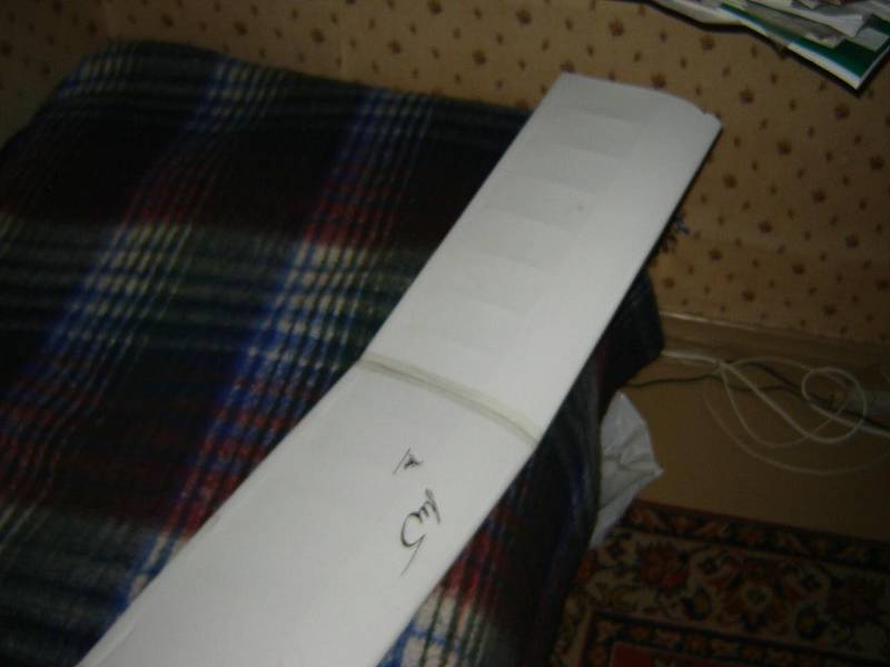

last year i finished my glider ... it is pretty light and good looking
but my teacher ... told me that this thing should fly but my glider is not good at flying ... dunno why [:'(]
i made video so here it is
http://rapidshare.de/files/28505318/..._PICId_067.mpg
its my friend [:-]
if u want i can make some more pics or videos
but pls tell what is wrong with this plane
i have made some more pics about my plane
and .... my teacher told me that under wing/s should be kinda brick/block but i didnt get it [&:] ... so u can see it on mspaint pic bit closer

Your link does not lead me to your video. How are you launching it? Hand launching it from the ground (not off of a slope) will probably get you nowhere but frustrated unless you are very good at launching it--which it sounds like you are not. You will have to find a very strong thermal to take it up to any altitude at all. To start, it's better to either take it up on the back of a plane, or throw it off of a slope and try to catch a thermal. The easiest way to find a thermal is to look for soaring birds (buzzards, whatever). When they are just soaring around in a farily tight circle, then they are probably in a thermal. Try to fly into that thermal--you will catch rising air and your sailplane should rise. If you must hand launch it from flat ground, then you need someone to teach you the technique, it is not something that is just intuitive.

Having watched the video, I would say that your friend is launching the model wrong. You should aim at the horizon or slightly below, otherwise, as in the video, the plane will loose speed going up and stall and you then try to overcompensate with the elevator and the plane will oscillate (porpoise) up and down.
It is also possible that the CG is too far aft.
The high start should help or find a hill as mentioned before, but make sure you don't launch the model pointing up.

Why your sailplane isn't a good flier could depend on the v-shape of the wing , at least it looks from the photo as if the wing has too much v-shape.
But you also check the wing for trueness/straightness and also have slightly wash-out in the tips.

From what I noticed on the video, the plane climbed, then dropped its nose, then repeated this.
If this is the case you need to check the incidence. You should also check the CG on it.
