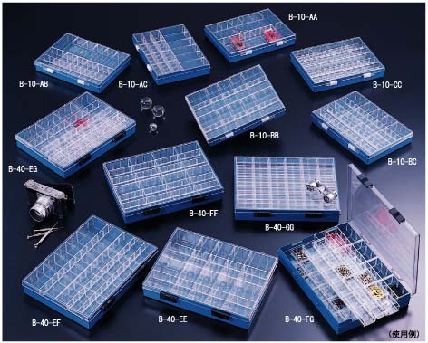

Hozan also offers parts cases for those small spare parts. They come in various sizes with various inner tray sizes as well.
