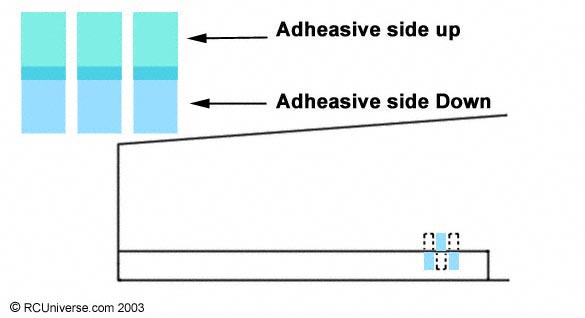

Here's the easiest way...
Cut 6 strips of covering about 3/8" to 1/2" wide and about an inch long.
Overlap two of them by about 1/4" (adhesive side facing each other) and seal them together - do this with all of the strips to make 3 sets.
Now weave them through the gap and iron them down as shown in the diagram - Voila!
