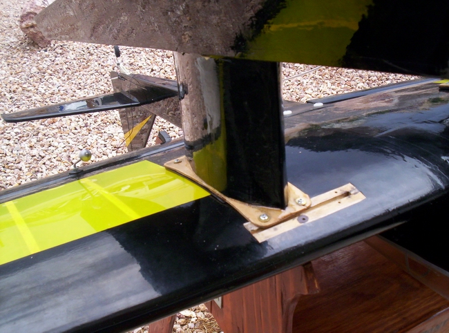

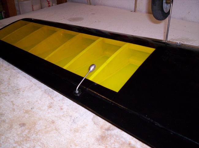

ORIGINAL: B.L.E.
Balanced surfaces are also a lot less likely to flutter at high speeds. This is why you see control surface counterweights on full scale airplanes.
Yes and on occassion it is effectively done on RC aircraft for the same reasons. Here is one way of doing it on a simple airplane with strip ailerons.
John
ID:	521646   Click image for larger version

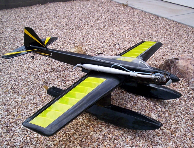

John,
I like that balance weight, and the float attach. Got another pic of the plane on the floats? I've had to balance control surfaces on a full scale and it's a pain in the rear. Had to jig up the control surface on it's hinge points, get a weight off the trailing edge, then calculate the weight required and it's location to get the proper size weight and moment arm.
Hoglfyer

John,
Acutally I had to balance ruddervators on a V-tail for my Airframe practical half of my A&P. I've also done them for a Decathlon and Pitts S2A after recovering the control surfaces. The Decathlon was the ailerons, the Pitts was all 4 ailerons, both elevators and the rudder. Talk about a nightmare!
What plane is that in the pic? The fuselage and wing have Bridi Super Kaos written all over it, but the tail is a bit different.

ORIGINAL: hogflyer
You got close enough, its a close to stock Killer Kaos the last of the Bridi kitted Kai.
