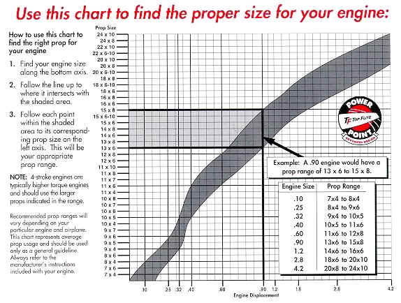

Default prop chart
start here :drowning:
