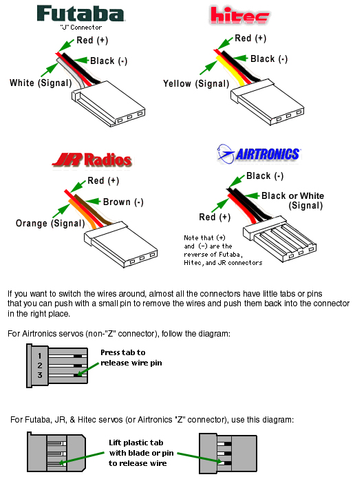

You can even use the older Airtronics servos too, you just have to change two wires. Use the attached diagram to see the wiring for each type of radio. The servos don't care what brand of receiver you have, just as long as the wires are correct.
Hope this helps
Ken

ORIGINAL: RCKen
Hope this helps
Ken
