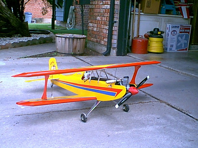

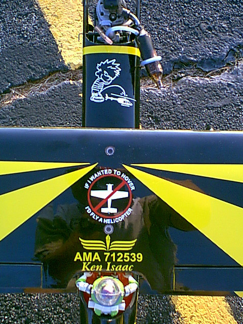

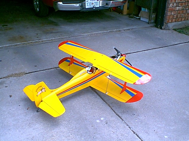

Here some pics of a couple of the Hog bipes I've had.

Where'd you find the Snoopy pilot Ken. [sm=thumbs_up.gif] I need one. I have the Sig Hog still in the box, but on the to do list. Hopefully this winter.

It was already in the plane when I bought it from a flying buddy, but he found it at Toys R Us.

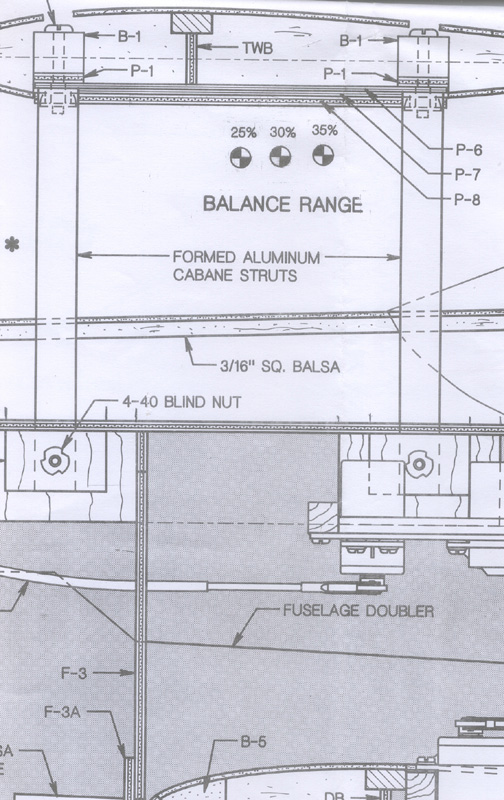

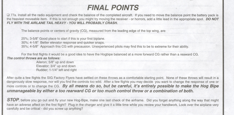

What is the recommended Center of Gravity on the Hog Bipe...? I have a friend that has his balanced at 4 1/2 inches back on the top wing... It seems to glide very good and has -1 degree of incidence in the top wing... I have just purchased an older model already built without engine and electronics.... and would like to know what your recommendations are for this bipe.. Thanks...

That is a great source of information for building a hog bipe... mine is built and I just wanted to know the recommended CG for the hog bipe... I read most of that post looking for the words recommended CG... I did not find that but I found how you can determine the balance.... I have since found the recommended CG for the Hog Bipe to be 3 5/8 to 4 5/8 inch from the leading edge of the top wing... recommended that you start with 3 5/8... thanks

Richard39,
Here it is scanned directly from the plans.
Hope this helps

thanks for the scanned info... very helpful.... Richard
