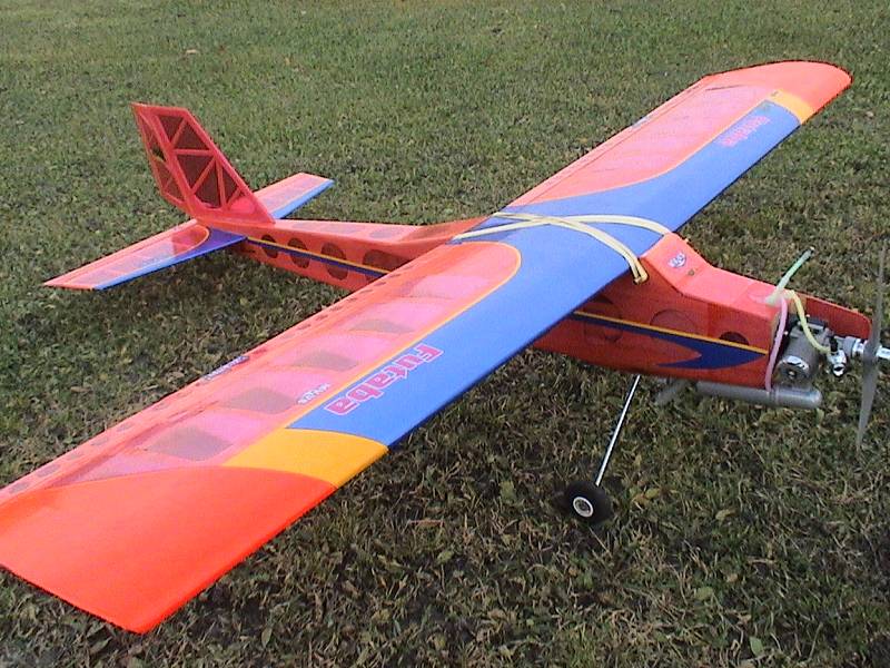

That Cessna is no good if he is a newbie! He will crash it in no time. Why? Brecause the airplane isn't as forgiving as a normal trainer These are the items that doesn't make it a good trainer.
It doesn have a a wing with enough dihedral. second the wing isn't thick enough (Thick wings fly better and are safer for a newbie) third all the scale pherefenalia on the plane is no good...may look good... but isn't for a newbie! These glassed windows (Will break in the first light crash), wheelpants (will hinder talke off and if the airplane evetually takes to the air...will be destroyed in the first hard landing...there are several more things about this airplane that makes it bad as a trainer but I stop here.
Here is what a good trainer look like. (Multiplex ARF electric trainer) or a wooden ARF trainer
(Kyosho Calmato).

OK I think you guys have pursuaded me to get a trainer first. I will probably buy the cessna later on, when I learn how to fly. I will most likely start out with the Tower Trainer. It looks like an OK airplane. I really didn't mean to say that trainers were boring, I take that statment back.
What do you guys think of the Tower Trainer? Will the O.S. .46 LA work well with it? Will some cheap Traxxas MT servos work?
I know flying is hard at first so I take back what I said.
Thanks guys....[8D]
Thanks guys....[8D]
The Tower Trainer will probably do a good job of keeping you occupied for a while. I've been working with mine for the past 3 months. Mind you I still fly with an instructor and haven't soloed yet. However on high rates, and with a .46, I've seen my TT do some fairly interesting aerobatics with a very experienced pilot at the controls.
The tower trainer with an OS46 LA is a great combo. I have heard that the Tower trainer flies fine with a 40LA as well but the extra power certainly wont hurt.
Not sure about the servos but standard Futaba servos are only $12 each.
