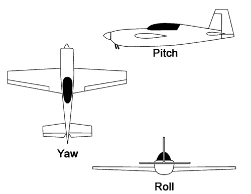

Default dumb question...
Roll, Pitch, Yaw:
Old 01-17-2003 | 06:16 PM
Posts: 23
From: Haltom City, TX
Wow, Pictures worth a 1000 words. Great diagram.
