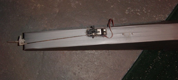

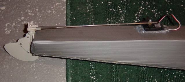

Joined: Dec 2002
Posts: 146
From: Dayton, OH
Default Trainer-Life Extension-
Whirley Bird,
I think the 46 LA did not have enough power with the extra drag of the floats. Nose weight may have helped but I was discouraged after my initial tests and bought a Ace Seamaster. It is a great flying sea plane.
Alstack,
This is how I set up my rudder. I just used a Y-cable and an extension and plugged it into the rudder channel. I had great water handling with it. Let me know how your setup works.
This is the rudder I used http://www2.towerhobbies.com/cgi-bin...?&I=LXE981&P=7

Old 02-02-2003 | 05:18 AM
Joined: Dec 2002
Posts: 146
From: Dayton, OH
Here is another angle
Old 02-02-2003 | 04:14 PM
Posts: 2,183
From: Davenport, FL
.Lookinup,WOW!!!!,
Now I see why you need something bigger then a 46 LA engine.
Those are some big floats you have there.
I can see where the plane will struggle getting altitude.
I have to look in the TH catalog and price out the rudder and floats.
Thanks for the pictures
Old 02-02-2003 | 11:18 PM
Posts: 222
From: Appleton, WI
Whirley Bird,
Alstack,
I am still trying to decide where to mount the servo. I was wondering if I could mount it in the fuse and use a flex cable or something like that. I have two of the Williams water rudders and would like them to work in tandum for more of a scale effect. Maybe asking for way more then I need. Hers is what they look like. http://www2.towerhobbies.com/cgi-bin...?&I=LXKK27&P=7
Al

Old 02-04-2003 | 03:12 AM
Joined: Dec 2002
Posts: 146
From: Dayton, OH
Alstack,
I originnaly wanted to do just as you suggest with the flex cable but to attach the pushrod housing to the floats would have made it more difficult to convert back to a land plane. Also I decided it would be much less work for me If I siliconed a servo into the float. Either way would work great I'm sure.
