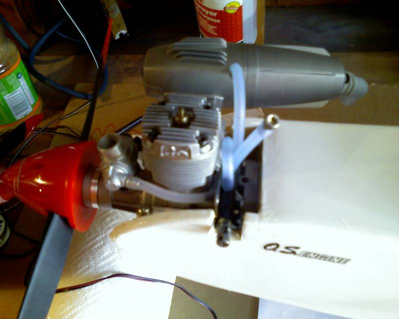

I have not flown my RC trainer plane in 2 years. I am going to start being trained on it again soon. I have a .46 TT Pro engine in it. The leaver that is hooked to the steel rod to the servo is the leaver that opens up the carb. when I try to push on the rod to get it to push the leaver to open the carb, the carb will not open or budge. The leaver does not rotate to open up the carb. I am not sure if it is froze shut or rusted shut or just because it has not been fired up in a long time? Does anybody know what may be wrong with it, or should I go buy a new engine?

didnt take long, first don't heat anything up with any flame!!! second it is 88$ to replace that engine from towerhobbies not to bad in case it is bad, if I was going to do that I would get a OS 46AX for 115$ but thats just me.
first looks as though the carb has a nut on the end of the shaft opposite the lever take some oil 3in1 is fine sewing machine oil is good or some fuel and just gently wiggle the barrel loose then rotate the lever until it feels smooth just don't manhandle the thing to break it free, you don't want to break the carb body.here is a shot of a OS 46 the nut on the carb side is by the lever yours should be opposite the lever, just use a small wrench to lightly wiggle the barrel until it loosens

ORIGINAL: StoneDeaf
I just put some 3 and 1 oil on in the carb area. When I turned the prop..it seems like the cylinder moves up and down freely with no grinding. just the carb hole will not open and close. I am guessing it is gumed up. Thanks for your help
If this doesn't work, put the engine in an oven at about 300 degrees for about 10 minutes. The heat will loosen the oil. Once the engine is hot, take it out, the carb will move while it's hot. Immediately apply some alcohol and move the throttle back and forth. Keep adding alcohol and moving it until the alcohol comes out clear. At this point, put it back in the oven for another 5 to 10 minutes to evaporate the alcohol, and then oil it up. I've had to do this to a couple engines, worked like a charm every time.
