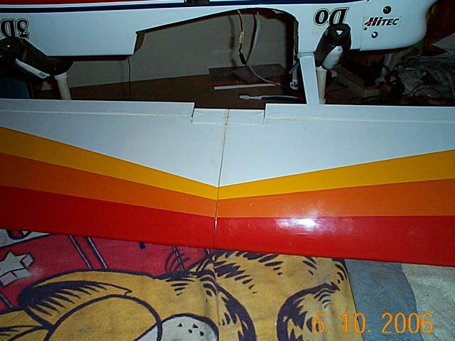

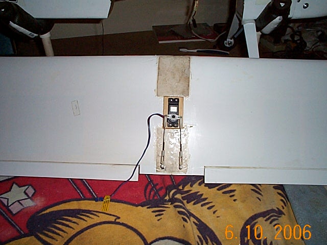

Timex10... I did the bottom of my wing when I put mine together over 3yrs ago, she
has been in alot of stressful situations and she's still together today, IIRC, I just got
the thinnest cloth I could find at the hardware store, removed the covering and epoxied
in place, weight was no problem... I started with the LA 46, and now she has the 46FX.
Here's a pic...
