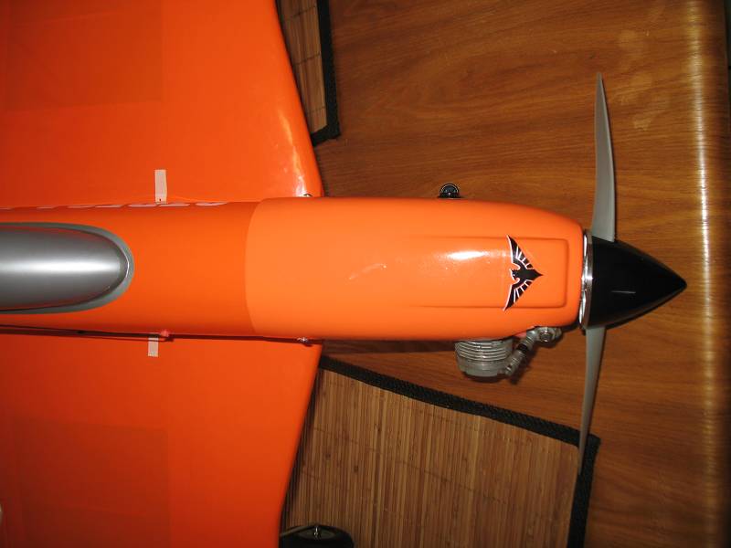

I got the phoenix models strega and it is all done! Powered by a TT Pro .46 ballanced at the recommended CG.
My question is: In the manual sais it should have a right thrust of 2 degrees and a down thrust of 0 deg. which seems to be built in the firewall. The thing is that visualy seems like a lot to me. Never had experience with this right thrust since it is my first low wing build. Any comments a very wellcome. Thanks!

For that aircraft, it will be about right, DON'T change it. you may need more or less, but don't change it because it "does'nt look right". Only flight testing will determine that.
I trust you will have an experienced pilot take it up for you!
Yeah, When I (rebuilt) the front on my 4-star it seemed like Way too much angle.. I laid it out by the plans and placed the firewall exactly where they called for it to be. I looked at it after the engine was installed and thought there was no way that it could be correct........Well long story short, it performed just as well as it did before the,You know...
(crash[:@])Good luck with your Strega! Looks like a real nice bird!

Thanks for the imput guys, I know I can always count on you Alan, your help has been very enlightning to me. Yes I will have a war bird pilot maiden it for me. Now please what are the simptoms of having the wrong thrust?

In actual fact, no right thrust &/or no down thrust, & the plane will still fly, get that straight in your head. IT WON'T CRASH. Ok the reason for adding right thrust to an engine is to help YOU fly the plane straighter through manouvers, like loops, stall turns & so on, I'll keep this simple, without too much technical crap OK. As the nose is pulled up in a loop, the torque effect of the prop, will make the plane YAW to the left, which takes it offline during the loop, that is the effect of too little right thrust, so some is added usually around 2 or 3 degrees, & this depends on lots of variables, eg. prop pitch, speed & so on. A good way to find the right amount of right thrust needed, is to pull vertical at full power, & adjust rudder trim to the right until the plane flies straight up, this may take a few tests to get it right, then land, & measure the angle of deflection of the rudder, note that angle, & increase the right thrust of the motor, exactly HALF that rudder angle. & check this with the radio on of course, So if the rudder trim moved the rudder, say 4 degrees, then 2 degrees, of right thrust is needed. More flight tests may be needed to confirm this setting, of course.
Ok now for down thrust, this is used to counteract the lifting forces of high lift wings, Eg, flat bottom wings, as on a trainer. The motor will pull the wing through the air much faster than it needs, to overcome the weight of the aircraft, & so it climbs, this is when down TRIM is applied, fine, but this is only effective at that particular throttle setting, any slower & the nose will drop, any faster & it will climb again.
So down thrust is added to the motor to reduce the effect of unwanted climbing under power, & also the plane will not need as much retrimming during the flight.
Sorry to ramble on, I have just come home from flying, & I had to maiden 3 new planes, 1 of which is a SIG Kadet, 25 size. It needed some down thrust, to help it fly better.
