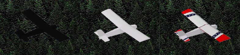

The one in the video is a really excellent scheme. It provides excellent visibility In all kinds of conditions, and good top/bottom differential.

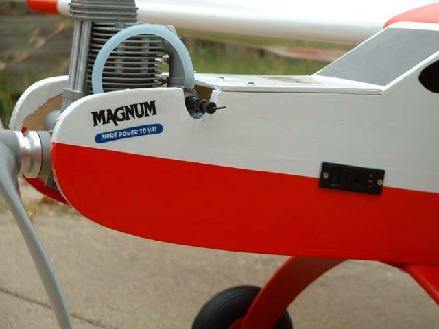

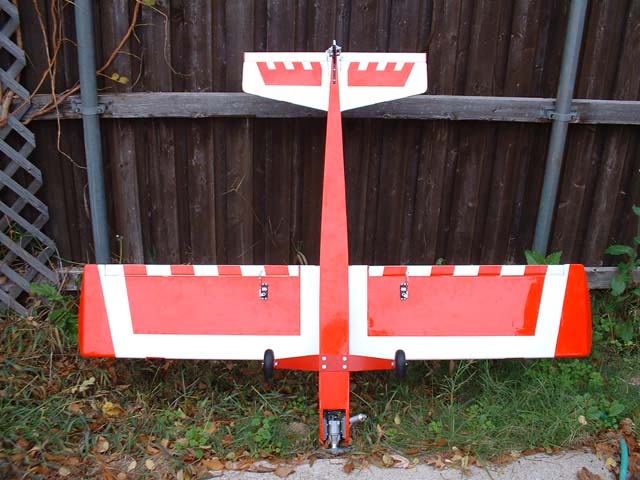

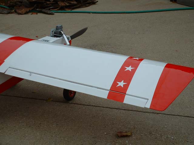

ORIGINAL: chashint
I am building a PT 60 for my brother, I think I will give this a try.

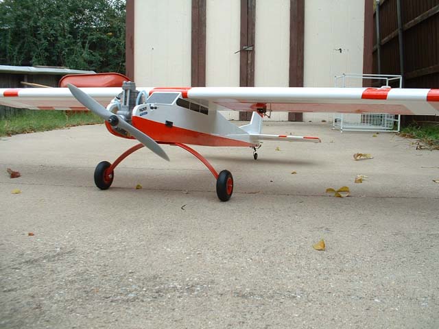

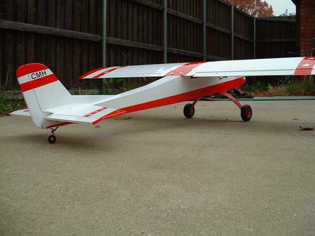

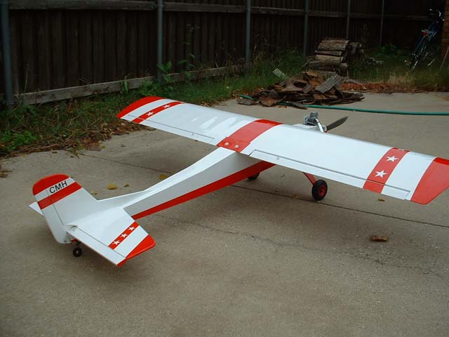

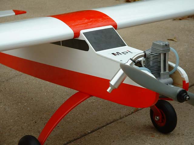

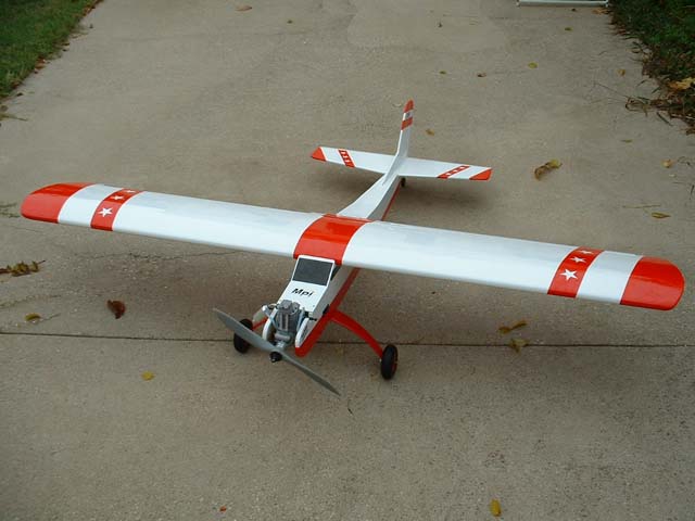

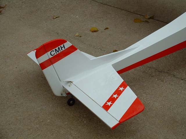

Here are the pictures of the PT-60 I built for my brother, it is modified a little bit but still a PT-60 at heart.
Thanks ti Minnflyer for the covering scheme.

Did the hobby shop have a sale on Red? LOL Just kidding. It looks great!
Old 11-28-2006 | 03:09 PM
Posts: 1,309
From: Rowlett, TX
Default RE: Covering scheme
LOL, I debated with myself for at least 5 seconds on the choice to go with just two colors instead of the three like your scheme really calls for and you can see what won out.
Since these pictures were taken I have dressed it with pin stripe tape like you showed in your videos.
I used 1/4" black on the color intersections with a 1/8" black side stripe set 1/8" apart.
I almost left this step out but I am glad I added it, the pin stripes really makes it pop and it adds just a little touch of a third color.
