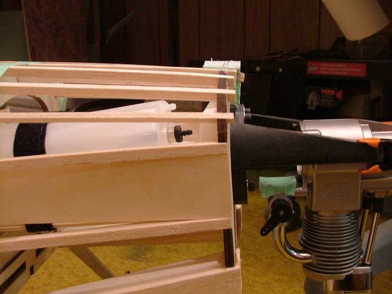

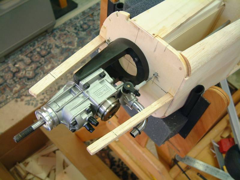

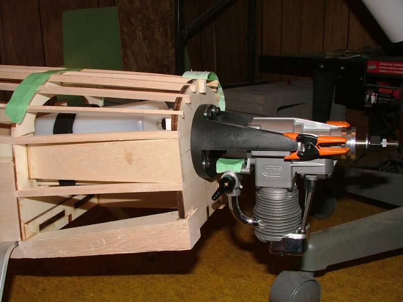

hmmm... i seem to have this tank way too high. i followed the builders plans etc. and he hasn't had any problems with his.
i am puzzled on what to do now.
have a look at what i have now. the linkage photo(the last one) is his reference photo of his plane. you can see the level of where the tank goes in it.
thanks
thanks
Hi!
The center of the tank should be inline with the carb intake orifice when the model sits horizontal! That's very important.
The depicted tank is way too high!!!
It's also vital that the tank is well padded with lots of soft foam rubber. That velcro isn't enough.
thanks for your reply...
i am going from plans that came with this plane on most of this build. i am using the exact same tank(Hayes 16oz), engine as it was designed for. i have, just today, lower the tank to make it closer to the carb level. seems to be a lot better now. took numerous hours to complete that task though. had to work out the throttle linkage as well to insure it wouldn't interfere...so far so good.

Looks like a very large tank. Can you find a tank that will fit between the firewall and the next former?

Doesn't matter what the manufacturere does if the tank is too high ..it's too high! Simple as that! And you have to do something about it if you want best flight performance...but on the other hand, if you can live with not so good engine behavior and reliability...go ahead
