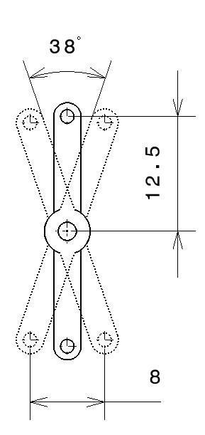

Guess this is a stupid question but how many degrees should a std servo travel? On my HS55 i've got +-19 degrees, is this normal?
The reason why i ask is that i need 13.5 mm servo travel for retracts, and with the included servo arm (25mm long) i only get 8mm.
//Hans

Most servos are capable of 60 deg full travel rotation. You'll probably need a retract servo for your retracts. The rotation of a retract servo is about 180 deg.

Dooh, 38 deg was only in one direction [sm=red_smile.gif] with 125% travel (max). I have a Hitec Optic 6 and want to use the HFS-05MS rx, can i use this for retracts? The rx only have ch1, 2 ,3 ,4 and ch6. I dont want to use any rudder so ch4 is available for retracts, can i use ch4 for retracts or must i use the dedicated ch5 as decribed in the manual?
For these retracts i want the servo to be in one of the max end positions and should travel all the way to the other end position with a switch on the tx, is this possible?

I will assuse with a hs55 as a retract servo this is a park flyer? The optic 6 should have channel mixing or programable mixes. Set channel 5 as master and channel 6 as slave should work ok. If you need more servo travel than the arm will give extend the arm with some thin plywood. I hope this makes sense.
A retract gear that locks is one thing.
A retract servo is another thing.
Most retract gears are designed so that when the gear is fully opened or fully closed, the strut is held and supported by the structure of the mechanism. No effort is needed on the pushrods to resist the force of landing nor to hold the strut/wheel up in the wheelwell. When the gear is up, there is no load on the pushrods. When the gear is down, there is no load on the pushrods.
Retract servo's are designed so that when the servo arm is at either end of it's travel, the servo motor is "turned off." That way, the servo is not constantly working to hold the gear down or up. It only works to move it. That saves constant drain on the battery. When the servo is all the way "up" it will not draw from the battery. When it is all the way "down" it won't draw.
The problem you have with a standard servo, even with good retract mechanism design, is that unless the linkage is adjusted perfectly a standard servo will feel a load and fight it. If the linkage is too long and pushes or pulls the retract unit past either "at rest" location, the standard servo will work and work and work and drain the battery. If the linkage is too short etc etc
