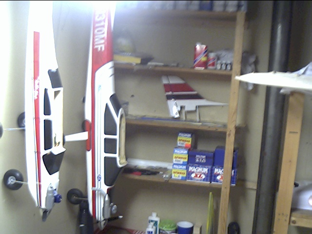

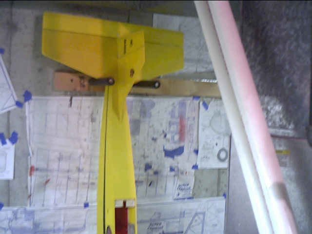

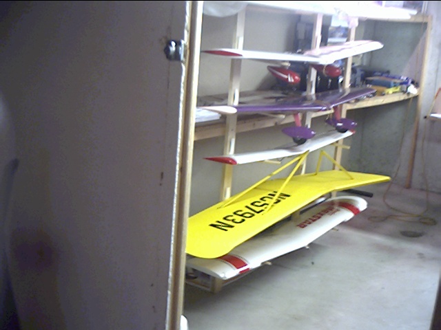

Here's how I do it for the fuesalage and the wing.

Old 11-15-2006 | 07:53 PM
hogflyer's Avatar
Joined: Mar 2005
Posts: 2,037
From: Wichita, KS
Default RE: Hanging Plane on Wall (stupid question)

The only thing I fear about hanging them in that fassion is damaging the stab from the weight of the plane / engine. Id be afraid I would have 2 indentions in the stab from hanging it.

I hung planes for years from the stab and have never had any damage. Don't worry about it.

I totally agree with Hogflyer and NCIS. I have a lot of my planes like this also. The way I usually hang them is to use an eye hook and bungee cord to hang it with. I will screw the eye hook into the wall (preferably in a wall stud so it doesn't pull out), then open up the eye hook enough to put the bungee cord in it, close the eye hook loop, and then hook the landing gear of the plane with the hooks on the bungee cord. This keeps the fuselage flat against the wall and since the landing gear is what's hooked you don't need to worry about any "hanger rash".

If you are hanging by the horiz stab, you may want to put something long and somewhat stiff on the leading edge for the bungees, cords, etc to rest against. I believe what daroc is referring to is that it may put an indentation in the wood. If you put something stiff on the LE it would spread the stress over a wider section and would prevent the cord from 'digging' into the LE wood. This digging could result from the weight of the plane pulling down on the cords that are holding the plane by the horizontal stabilizer.
You could use something like the core cardboard tube from inside a roll of toilet paper or paper towels. Cut it in half lengthwise and place it on the LE of the stab. This way the cord, bungee, whatever will rest against it. You could even use the foam material that a lot of guys use for the field kit stands, etc.

I hang mine by the tail on 1/2 inch dowels. I use 1/2 inch pipe insulation foam to protect the tail.

a easy adjustable rack for planes is to go to home depot or other hardware store get some adjustable shelf standards the kind with the slots in them they come in 4'-6'-8' lengths get the # of shelf brackets you need screw then to the wall and use foam plumbing pipe insulation for padding they are allot like NCIS's wing rack but you then can adjust for wing and fuse sizes as they change a 4' tall unit will hold as many as 4 planes jammed in but I have 3 in mine fitting loose and out of the way without any trouble installs with a screw gun/screw driver in a pinch and some scissors to cut the padding
