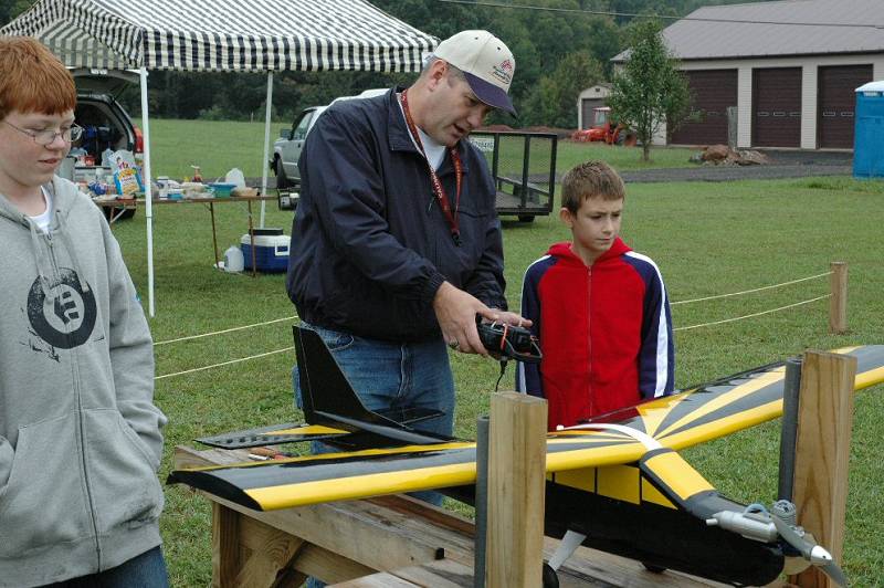

Skip the stock color scheme. Be creative. Be bold. A little imagination and you can have a plane that really stands out from the crowd.
Use a distinctly different pattern top and bottom. When it gets further away, you'll lose the color anyway. Its the pattern that makes it visible.
For example, here's a Nexstar I stripped down and recovered when another club member crashed it and gave it away.

Nice looking Nexstar bkdavy. How do you keep the black shiny like that? When I cover I still get the disappointing marks, streaks and smudges. As I am not new to building, my covering still needs quite a bit of work to be as shiny and nice-looking as yours.

ORIGINAL: tigerdude426
Third, make sure the pictures are taken at an angle in poor light - the scratches and fingerprints won't show as well
Brad
