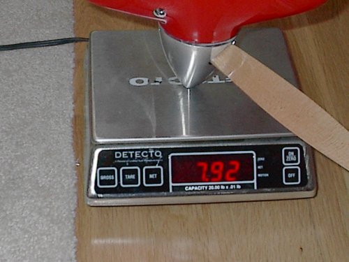

i really apriciate it i only have one more question how did you get your weight down to 8lbs all other threads have read that it comes out of the box at 9.5-10 lbs. did you do anything or did these people put monster engines on them to get that weight.
malin
and thank you again for the help
Old 01-27-2003 | 04:59 AM
Posts: 6,378
From: Bloomington, IL
Default help with edge 540
All I did was put it together.
Some guys were making the process of assembling that ARF way too complicated. Elevator bellcranks etc.
I had my elev servos in the tail and the rudder on a pull pull.
Easy.
