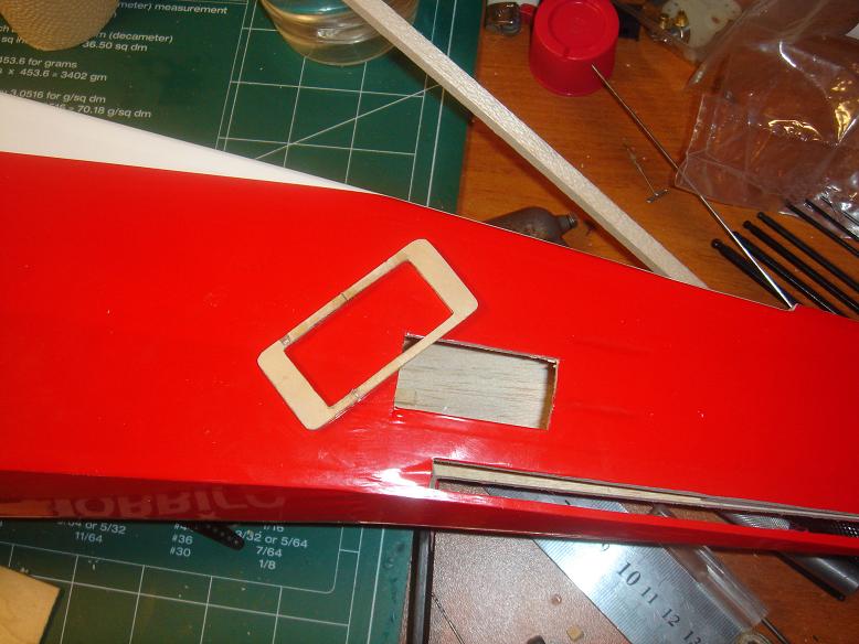

Old 02-02-2007 | 06:48 AM
  #87
Joined: Sep 2005
Posts: 117
From: Moscow, RUSSIA
Default RE: phoenix decathlon
hey primodus
well u can see in the photos there is a ply peice i put it in the elevator servo nest. this is dont to reinforce the area . i dont like the idea of mounting servos to balsa wood. the rudder servo is mounted a little closer to the elevator surface and closer to the front of the airplane . u basicly need to make the neccessary mesurements to make sure the servos fit in side the fuse with out touching each other. what i did was cut 2 cardboard tepmlates the size of the servo mounting dimensions and just played with them on the one side of the fuse to see where about the holes should be. i then cut one of the holes open and went on to the other sipe of the fuse. u can use the stock pushrod opening s as a guide to where the other servo should be. the fit is pretty close but there enough space to fit both servos. be aware that putting a servo to far back may cause it not to fit as the nest will not be deep enough to accomindate it . also installing it too far forward will lead to to the frame inside the fuse ... the mounting lugs should be just before that frame so that u can install reinforcments for the servo screws.
good luck
if u have any further questions please ask

Old 02-02-2007 | 10:31 PM
  #88
Primodus's Avatar
My Feedback: (56)
Joined: Jan 2004
Posts: 1,183
From: Fayette, AL
Thanks for the pics Buka. I am going to study on this one for a bit, but it looks promising.

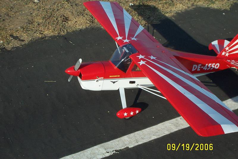

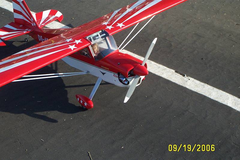

Old 02-04-2007 | 11:14 AM
  #92
IronCross's Avatar
Joined: Aug 2002
Posts: 2,409
From: NearBy, AZ
I have two of the Pheonix SD's.. I put a Saito .56 in the first one and had a blast with it... I wanted a little more power though so I put a Saito .72 in the second one... Perfect match for me.. The Satio is swinging a 14X4 APC prop on 15 percent PowerMaster fuel.. Lots of pull...
Both engines are mounted in the supplied mounts in the as comes location... I mounted the engines as close to the firewall as possible and then fit the cowls... No problems there.. I did end up nose heavy though so I cut the covering on the bottom and mounted the battery pack about midway back in the fusalage and replaced the covering...
I also added some differential to the ailerons so I did not have to use the rudder in truns... Makes beautiful turns now...
Take offs get a little squirrly at times and can get ugly but the .72 has the power to pull me out of a lot of them... Once in the air I love the way this plane flys... I don't understand the "pig in the air" comments at all... I have the elevater etc set at recommended throws and have not had it snap on me yet... Just a pleasure to fly....
On landings I find that I have to keep 3 or 4 clicks on the throttle and let her settle in cutting the throttle about the time the wheels touck.. If I chop it while the plane is higher it will bounce every time...
IMHO these are well worth the money...
