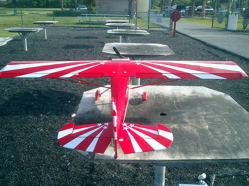

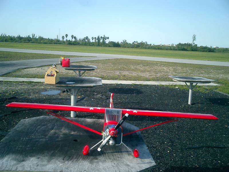

#178
Joined: Mar 2004
Posts: 44
From: miami,
FL
Well here are some pictures I took two weekends ago. Next time I will more detailed pictures. The screws that hold the wing strut came off from vibrations and I just replaced them with cable ties. I will change this back to screws but will put a nylon nut or loctite them. How do i upload pictures? could not find any buttom for it.

Sorry to keep asking questions but.... How did most of you guys run the exhaust with a four stroke on the factory mount? I was thinking about putting it in the cutout section behind the cowl and using a diverter to get the exhaust to go straight out the bottom of the fuse. Trying not to cut the cowl up anymore than I have to.
#180

Jason,
I'm using an extension out under the fuse. It is from Hobbico. Gray silicone and comes with two plastic ties. Works good but they have a tendency to fall off. Perhaps a wire wrap might be better but I haven't tried it yet...$3.00 ! You might want to consider painting that area for a little better fuel proofing.

#181
I ran the exhaust on both the .56 and .72 right into the cutout... No deflectors or anything used... The clearance on mine is more the adequate .... No problems at all... I did also however cut a hole in the bottom om my cowling for cooling and to allow me access to the LS needle on the carb... Whole thing works great....
