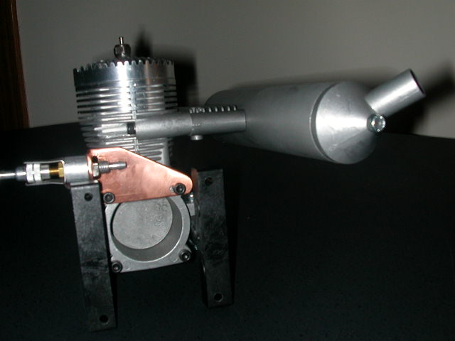

Old 01-29-2003 | 11:40 PM
Joined: Jun 2002
Posts: 240
From: Elizabethtown, KY
Default Pressurized Fuel Tank
Dan,
Here are a couple of pictures of it. I got it off ebay so I don't know if it's stock or not. (the copper piece I made to hold the remote needle valve)

Old 01-29-2003 | 11:45 PM
WORNBOOTS's Avatar
My Feedback: (33)
Joined: Aug 2002
Posts: 1,147
From: Texas, TX
hoppy can You get a pic straight down so I can see the part where the manifold is bolted to the engine?
It looks like the same muffler I have
Dan Z

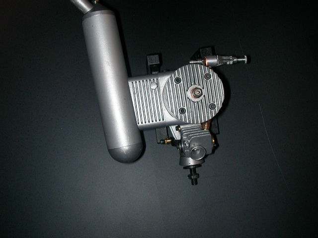

Old 01-29-2003 | 11:52 PM
Joined: Jun 2002
Posts: 240
Dan,
Does this help? I can't find anywhere to connect the hose.

Old 01-29-2003 | 11:55 PM
Posts: 821
From: Cincinnati, OH
looks like you might have to tap the muffler and put a nipple in. It's not hard. Get a nipple from tower or LHS, the instructions will tell you how big of a hole you need.

Old 01-29-2003 | 11:57 PM
WORNBOOTS's Avatar
My Feedback: (33)
Joined: Aug 2002
Posts: 1,147
From: Texas, TX
See that round spot between the fins next to the joint between the engine and muffler?
Mine is tapped and threaded for the pressore fitting,
How soon will You be ready to fly? You could tap it (take it to Your LHS they should help) or I can Trade You the one I have
Dan Z

Old 01-30-2003 | 12:00 AM
Posts: 490
From: vancouver , WA
Default thx hop
just courious, thought i saw something, but these guys are right , just get the nipple and drill the correct size hole, its a self tapping nipple

Old 01-30-2003 | 12:10 AM
Joined: Jun 2002
Posts: 240
Nevermind Dan, I found some at Tower like everyone here said. Thanks for the help everyone. Didn't know you could buy the things......

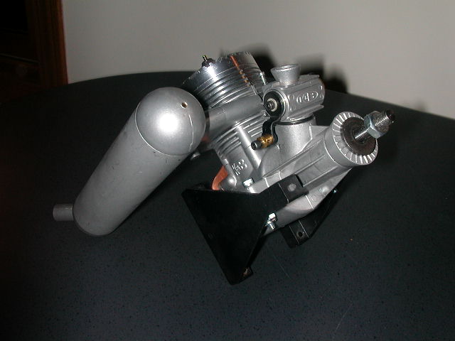

Old 01-30-2003 | 03:44 PM
MinnFlyer's Avatar
Posts: 28,519
Received 9 Likes on 9 Posts
From: Willmar, MN
Do yourself a favor and tap the body of the muffler instead of that flat spot. That is a low pressure area, the larger body of the muffler is the high pressure area (look up Bernoulli's principle).
Old 01-30-2003 | 03:51 PM
Joined: Jun 2002
Posts: 240
MinnFlyer,
Would the radius of the muffler effect how the fitting seals?
Old 01-30-2003 | 05:24 PM
MinnFlyer's Avatar
Posts: 28,519
From: Willmar, MN
It shouldn't, the fitting comes with a seal that will conform to the shape. Besides, the threaded part of the fitting has a slight taper to it, so it should seal even if the top doesn't even come in contact with the outside of the muffler
