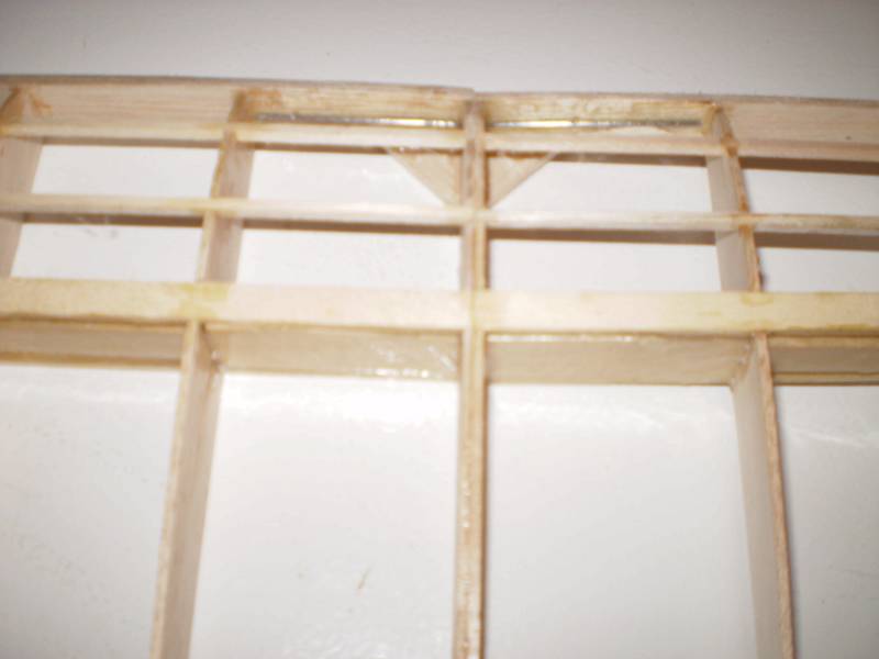

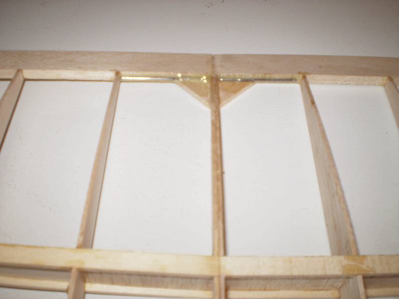

hey guys!
i am about to start covering my plane. I had to take a couple of weeks of for some other honeydos but now i'm back to work on my butterfly.
I just wanted to show how i strengthen the wing joints so they will NOT FOLD.
1st i used a 1/8th inch thick ply and made a gusset to go into the connecting ribs and touching the adjoints ones. Then used expoy to srt them in place.
2nd i used the included 1/16 music on the leading edge and trailing edge. Look at pics. I expoied them to the L&T edges so give exrta support.
I have an idea on how to stop the wings from fluttering but i don't know if i will use it or not.

Looks like you are getting it done!! Keep us informed as to your progress, it's fun to watch someone else do all the work, and we would like to see what it looks like when done.
I still stand FIRM on flying it EASY and SMOOTH, it will last a lot longer that way!!!!!! ENJOY !!! RED
