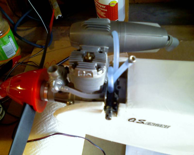

os 46fx break-in, being a newbie I read the manual on engine break-in......I was kinda confused that the instructions said to run it at full throttle on rich mix (four cycle sound), for ten seconds, then lean it out to two-cycle sound for ten seconds and repeat this procedure until you run a tank of fuel----back and forth every ten seconds.........I hear there are different methods of running-in a new engine.........I just want to know is this the preferred method....

thanks guys, also I would like to know if a muffler deflector will make a difference in the break- in, see-as-how I don't want to get my good looking "stik" too oily before her maiden flight. I had one on my .40 LA, on my trainer, and I was told that the engine would have to be tuned differently with the deflector..........if it is best left off, I would not have a problem with it.......

One of those short angled ones (about 2-3 inch long) won't hurt anything. A long pipe would change the backpressure. Deflector may cause you to change tuning by a click or 2, nothing worse.
!Seriously, don't worry about the oil. The deflectors are pretty much worthless on trainers. Just means the oil slick starts an inch or two further back.

I have two 46's, one 50, one 61, one 90, and three 1.20 OS's. I've followed the book method of break in and find that each and every one runs reliably and efficiently. The oldest engine is the OS 50, about 4 years old now, and it still runs just great.
As Bruce said, the main purpose of the changes in mixture is to allow the piston to seat in the sleve and to get a good match for the piston to the sleve in side the cylinder. The "large" amount of oil passing through the engine during the rich sessions will also help to flush out any flake metal that may exist or may form during the break in process. The oil may be slightly dark or almost black in color for the first tank but will eventually change to the color of the fuel you are using. I use S&W 15% which is a rose color. The oil the engine spits out is red in color.
As far as deflectors are concerned, well, I use them, but as someone said, they deflect the oil perhaps a couple inches back. It still will get all over the fuselage behind the wing and all over the tail feathers. The only exception is on my Venus II with the muffler pointing straight down (engine is mounted on an angle). With a deflector, I get a minimum of oil on the tail. It tends to deflect the oil enough away from the underside of the aircraft that I don't get much accumulation at all.
Stick with the manual and break it in right. It's worth the effort and, after three tanks or so, it will run just great and consistent, and keep running that way for a long time.
Don't over or under prop the engine either. Prop it to keep the RPM around 12000 at full throttle on that OS 46 and you will be a happy camper as to it's performance.
