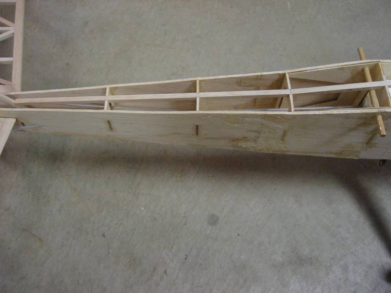

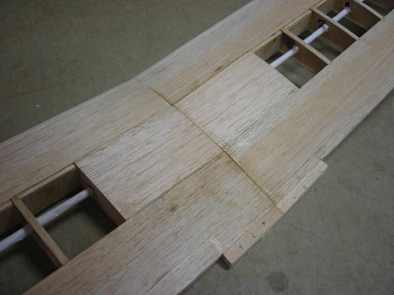

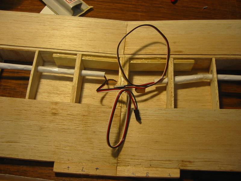

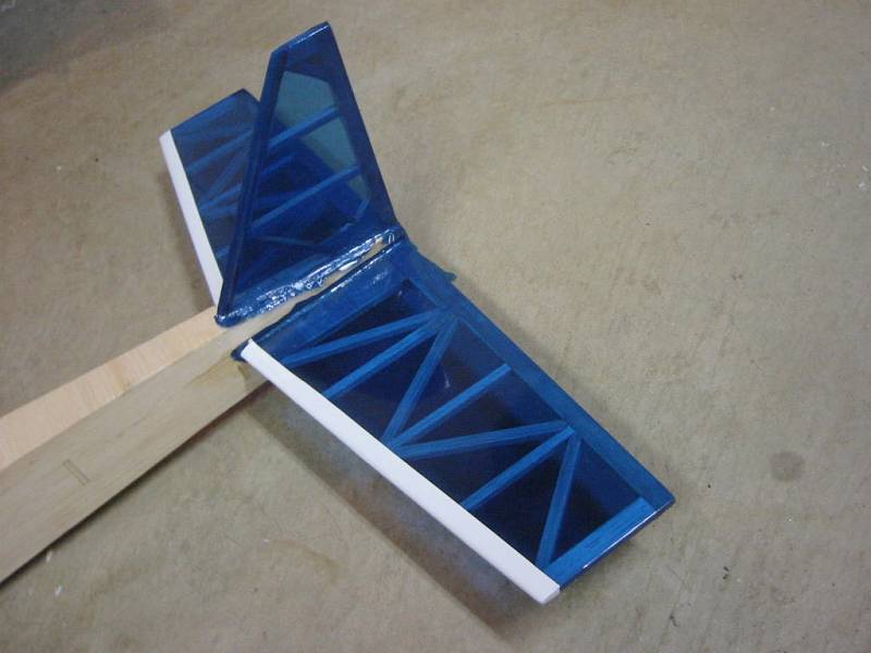

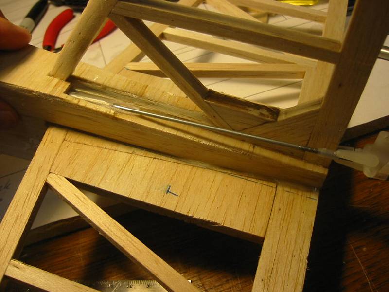

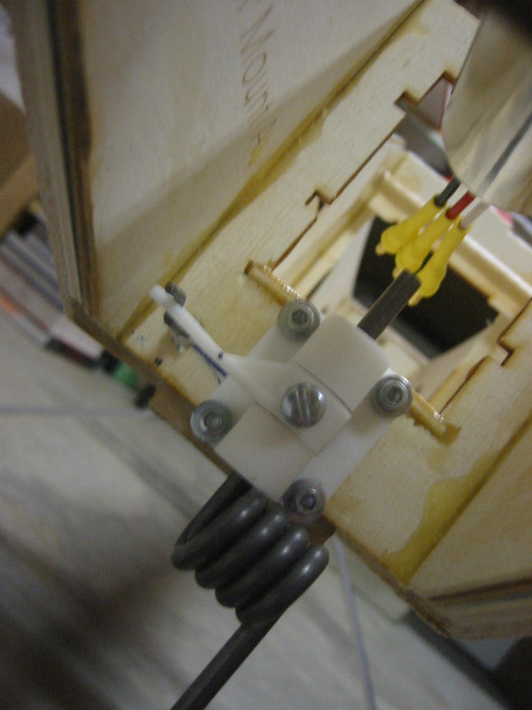

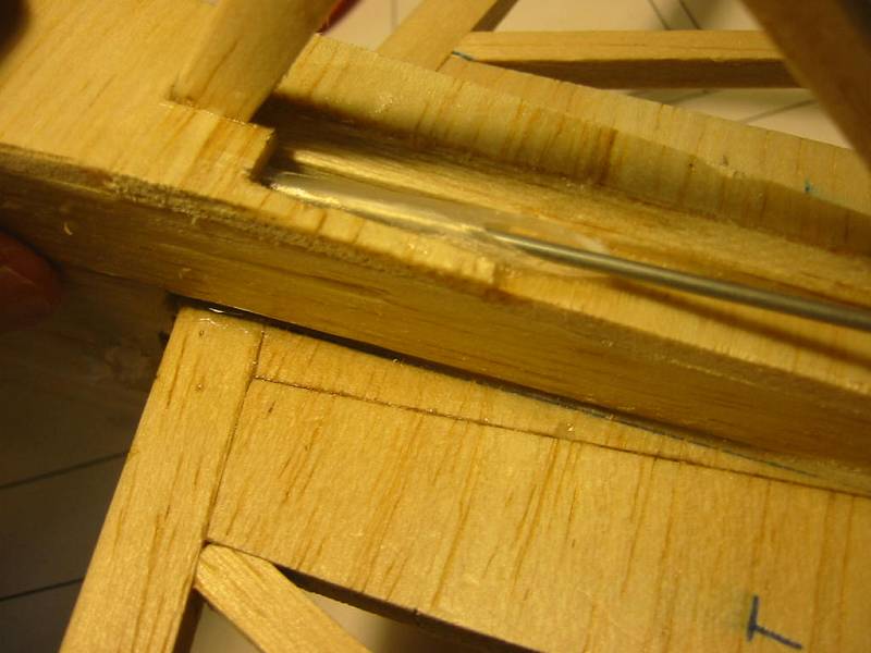

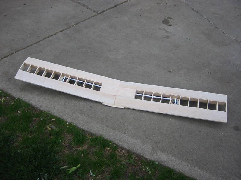

Well i had some time this weekend to get some work done on the project, and its been going together smoothly latley, which is nice. Hopefully the pictures say more than words can, enjoy!
-David

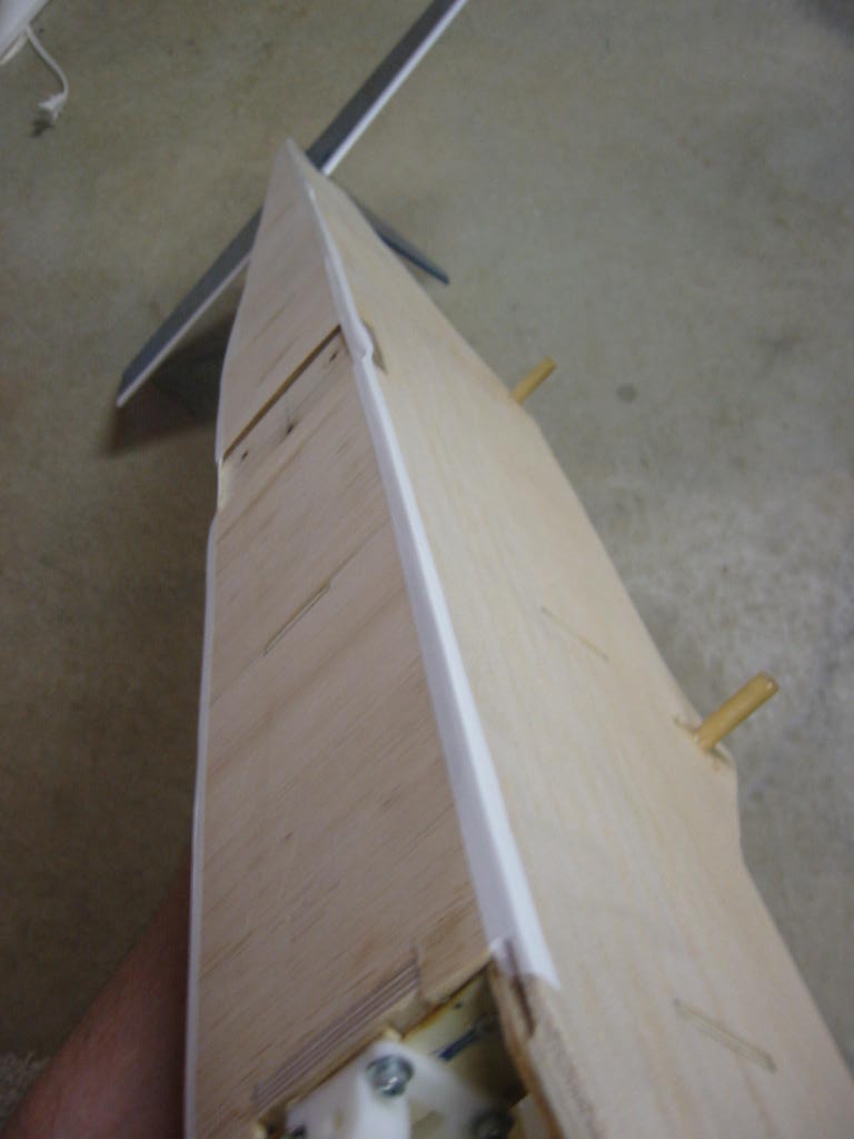

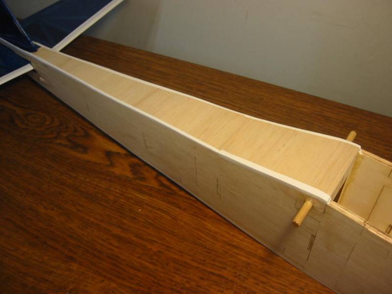

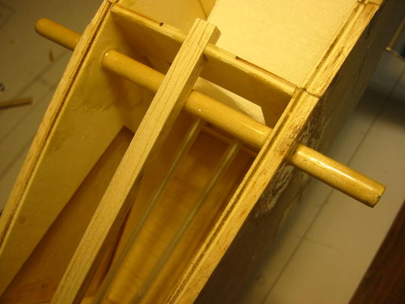

Well i spent a few hours yesterday completing the sanding process of the fuselage, and getting it ready for covering. Then started on the covering process with the elevator. Hope the pictures turned out good, i can never tell if they are worth posting sometimes. Enjoy!
-David

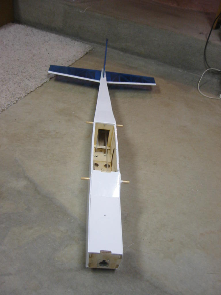

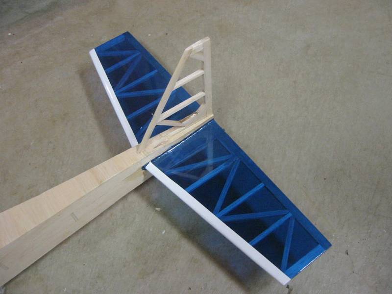

well more coverings underway! have most of the tail surfaces done, except for the actual control surfaces, and the white stripe on the front of the rudder. also started the covering process for the fuselage by putting the strips on the edges/corners. planning on using transparent blue, white, and transparent red. Let me know what you guys/gals think.
-David

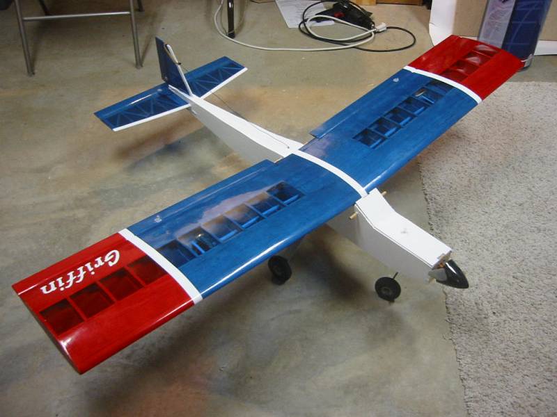

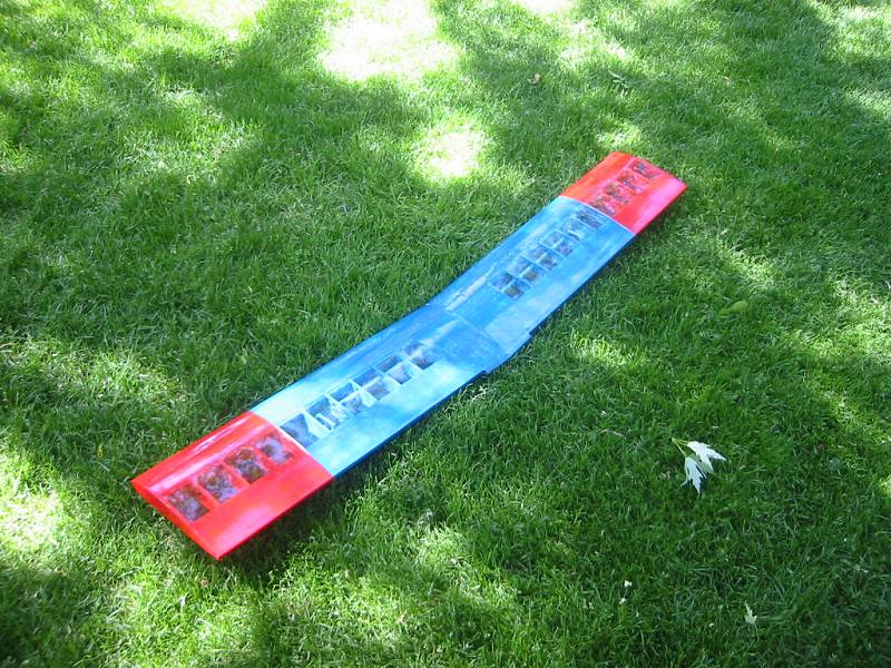

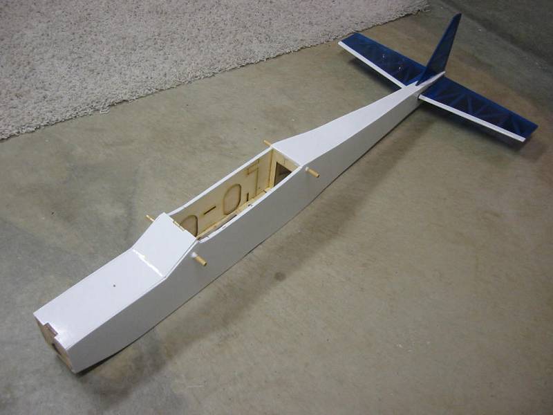

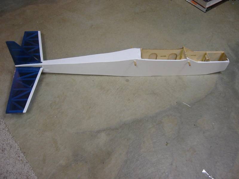

Well the weather was great yesterday, but i had to work from noon to 6pm so no flying for me but i was able to get some covering on the Griffin done last nite.
The fuselage is pretty much covered and rdy to go. cant decide if i want to add a red accent mark down the side of the fuselage or something similar, what does everyone here think??
I Should start covering the wing today or tomorrow, have to balance the wing first then can get started.
So whats everyone think so far?
-David

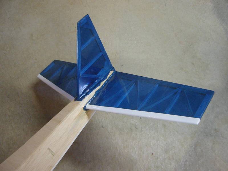

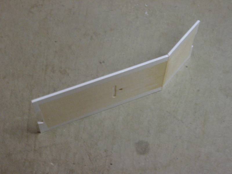

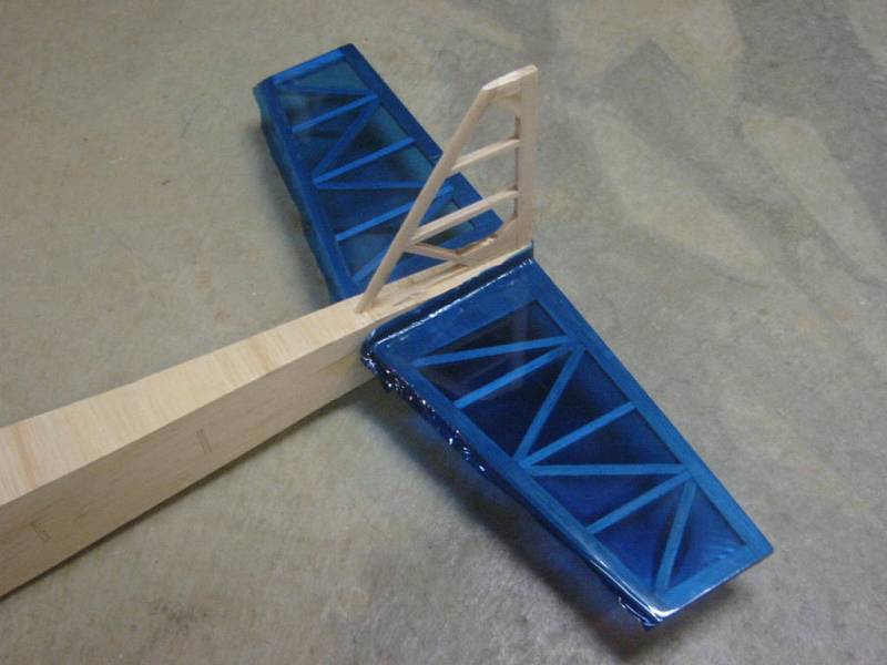

Attached are some pictures of the work i've been able to accomplish on the plane recently. Its taken a bit longer than expected because when the weathers nice, i'll end up going to the flying field instead of building, haha im sure everyone has that happen to them to Hope everyones enjoying the build log and all of the pictures. I'm always open to hear what others think of this project, so please feel free to share. thanks
-David
