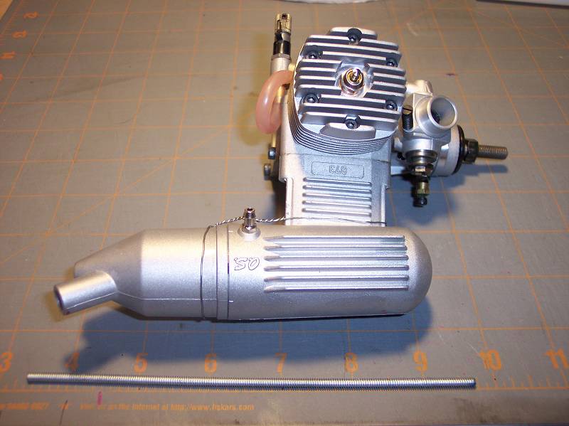

Hey all,
I'm having a difficult time keeping my muffler back-half from rotating, thus throwing out all the black gunk. Engine is a .46 Evolution on a Pulse XT. Anyways, whenever I've tried to tighten the nut down for the back half, it will never get tight. It will continue to spin, and the screw up front doesn't rotate at all. Someone at the field told me this was probably because the threads were stripped on the screw that runs between the two halves. They recommended putting on some washers in to act as spacers so I could get it to latch onto good threads. The problem is, this doesn't work either. I've tried putting a bunch of washers in, but there doesn't seem to be any good threads left or the nut itself is bad (is that even possible).
Any advice or instruction on what to try next?

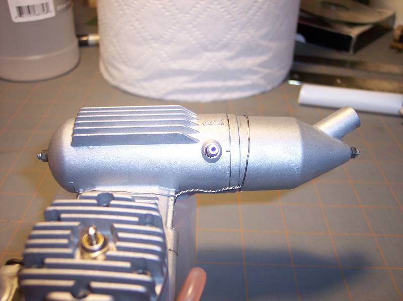

Hey ken, that is a really good idea to have that safety wire on your muffler just incase it can get past the double bolts. If everyone did this nobody would ever loose the back half of their mufflers.

Bruce,
Yep, those are the locking nuts I got from you. Those are aviation grade nuts. For those that don't have access to that type of hardware just use a stardard nut and double it up.

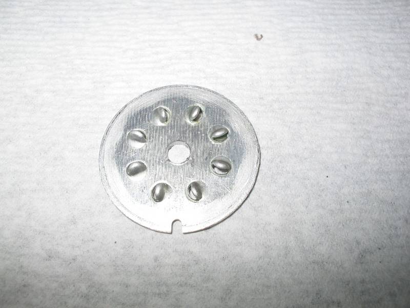

On the Evolution muffler the bolt tightens into the outlet half and the nut is just a jam nut. Loose the nut and really tighten the bolt and tighten up the jam nut. Also if it came loose make sure you check the position of the drain slot in the baffle so it can drain accumilated oil in the muffler.

Good call on double checking the position of the drain slot flynte. When I had my muffler apart, I didn't even realize that was there. I assume it should go toward the bottom?

The muffler is subject to tremendous vibrations. I have seen many people lose the muffler in the air, and then, sometimes, crash. I have almost zero problems now. I use automotive silicone adhesive sealent on everything on the muffler, including the gasketed joint between the engine and muffler, and the muffler halves. At the first sign of a leak in that area, I take everything apart and re-do it. I probably re-do it 1-2 times per year.
