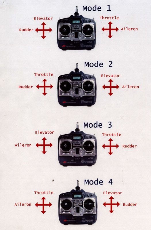

I own a Tower Hobbies System3000 and I was just wondering . . .
Are the System3000 controls different from my Futaba TXs or did I hook up my controls wrong on the Futabas?
On the System3000 the rudder control is on the LEFT stick (ch#1) instead of the RIGHT stick (with the elevator control) as I have it on my Futaba's, and the aileron control is on the RIGHT side (ch#4 I believe) unlike my Futaba's which are on the LEFT stick (ch#1).
Are the controls supposed to be reversed on the two brands or are the rudder controls supposed to be on the LEFT stick (ch#1) on my Futaba airplanes?
Please let me know ASAP as I will need to bring my Kadet LT-40 and Senioritta up from the cellar to change to the left stick.
I don't believe I have the channels wrong on the Futabas because I have that booklet and that is how they are displayed:
Elevator and rudder = right stick, Ailerons and throttle = left stick
As I have them hooked up now for the System3000: Elevator and ailerons = right stick, Rudder and throttle = left stick
Please straighten this out for me.

It sounds like your Futaba transmitter is Mode 1 (Europe) and your Tower Transmitter is Mode 2 (North America). You can have either converted to the opposite mode by sending them in for factory service.

Depends on what type of aircraft you are flying, & what mode you fly, if you fly mode 2, & the primary control is the rudder, (3 channel) then rudder would be on the right stick, if ailerons are your primary control, then ailerons would be on the right stick.
More info please, would be helpful.

It's not really "right" or "wrong" as much as it is simply a matter of what you're used to. Like driving on the left side of the road, or drinking your beer at room temperature...

If you haven't done any flying, sell your Mode 1 gear. Flying is based on muscle memory. Once you've got the movements down, you don't think about them when you fly. Mix your modes, and you're likely move the wrong control at the wrong time. If you stick with Mode 1, you'll always have to buy it--and it's uncommon here, which will limit your options. You won't be easily able to fly other peoples' planes, either.
In my opinion, keeping what you have at this point makes very little sense.

So Mode 2 if using an instructor. It is my understanding now that RC clubs fly in mode2 then? Mode 2 (which is what the System3000 is) is as follows: Please fill in the correct ch# for me . . .
LEFT stick = Rudder, channel #____; Throttle, channel # ____
RIGHT stick = Elevator, channel #____;Ailerons, channel # ____
I do occassionally have a problem with elevator and rudder being on the same side as sometimes when I move the rudder stick the elevator moves also (that could probably be a problem during flight
but wouldn't that also cause a problem with elevator/ailerons?
So back to my other question as well: Does my 4EXA Futaba computer TX have the option of changing the mode to 2?

Futaba's mode two channel assignments are
Channel 1: Ailerons
Channel 2: Elevator
Channel 3: Throttle
Channel 4: Rudder
Look at your Futaba radio. From right to left are the trim adjustments. On the right side gimbal you have Aileron (Channel 1) that slides or clicks left and right. You also have Elevator (Channel 2) going up and down.
On the left side gimbal you have Throttle (Channel 3) going up and down, and Rudder (Channel 4) going left to right.
The trim switch layout matches how Futaba assigns their channels. Kind of like and arch going right to left in ascending channel number order. I came across this little mavel of engineering by accident. Knowing this little trick really makes it easy to setup an aircraft.
What it really sounds like, is you set up your servo connections wrong. The Tower System 3000 is made for Tower by Futaba, as Tower has a vested interested in Great Planes and Futaba. Change the connection of your ailerons and rudder at your RECEIVER to match the layout I gave you above, and you shouldn't have any more mix up problems.
This should also keep you from spending any money on shipping your radios back and allow you to spend it at the LHS instead.
Please PM me if you have anymore questions.

Well don't I feel stupid now [sm=bananahead.gif]. I just pulled my LT-40 out and took a look at it. IT IS SET at mode 2 -
Channel 1: Ailerons (right stick)
Channel 2: Elevator (right stick)
Channel 3: Throttle (left stick)
Channel 4: Rudder (left stick)
I need a vacation. Sorry to waste all of your time asking something I shouldn't have forgotten about setting up the first plane I built. Another reason for getting out and learning to fly. If I had been flying the plane I would have remembered.
