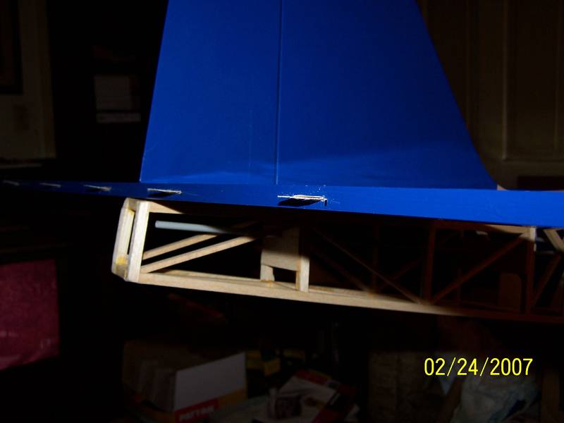

I have done a search and can't find exactly what I am looking for.
I want to make my SIG Kadet Senior into a tail dragger.
How do I go about making it....
Is there anything on the market I can get ?????

You need to glue a 2 or 3" long piece of 1/8" lite ply matching the width of the rear section. A local hobby shop like Hobby Haven
should have a DuBro or Sullivan tail wheel kit for either 40 or 60 size. It comes with a plastic mounting base and wire to be bent to enter the hinge area of the rudder. Correct dia wheel will have to be bought separately.

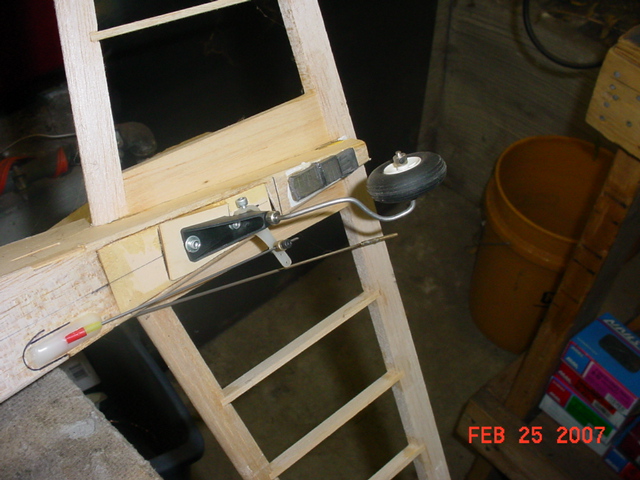

This is a photo I couldn't post earlier.

I have a Hobbico Superstar .60 that I am converting to a tail dragger. I am going to use a steerable tail wheel bracket. I have had it in my parts container for a long time, so I'm not sure who made it. The Superstar has a rudder that does not extend below the elevator, so piggy backing the tail steering to the rudder was not an option. The rudder push rod is on the opposite side of the plane from the tail wheel horn, so I can use both side of the servo arm in the plane.
