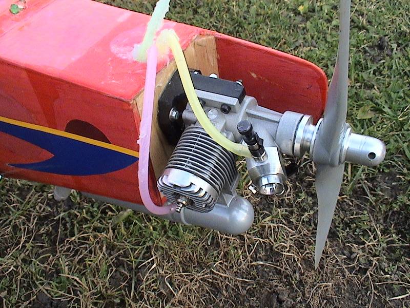

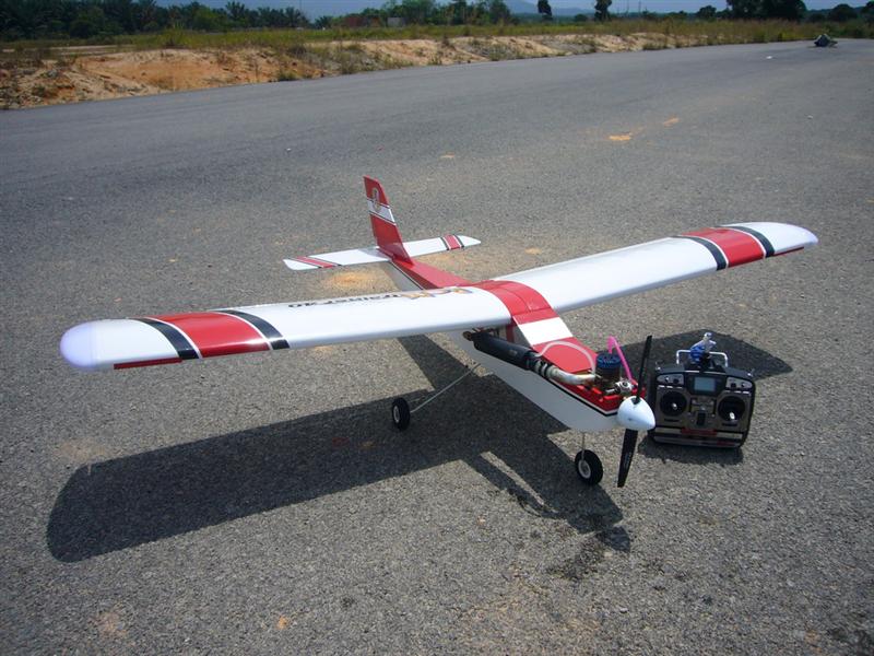

Well guys, I swapped the TT trainer for a RCM trainer at the last minute..here's a pic of it with the MVVS engine. maidened it last sunday =) engine seems not to be tuned right yet,,keeps dying on me and i get a lot of dead sticks =(

Sounds like you have a break-in problem, a tuning problem, or a fuel problem. Go to the MVVS support pages and do some reading. They have good articles on break-in and tuning, and several posts on what fuels to use.

Remember no more than 5% on the fuel. I also would suggest you turn the silencer so the pressure tap is on the bottom, that will help keep oil from accumulating and running back toward the port(actually had that happed to me on a ST 51).
Bet your low end is in need of a little help and don't totally peak the high end or it will also create a lean condition. Back off several clicks on the high end until you get the hang of this engine.

Default RE: Thunder Tiger Trainer 40 with MVVS engine
Hi!
Part of your problem is due too the fact you have mounted the engine upright ...which makes the tank position too low.I don't think it's an idle problem, or a running in problem, as all MVVS engines throttle perfectly from the first tank...as all other engines do.
Center of the tank should always be inline with the carb when airplane sits horizontal. This is something that every experienced R/C flier knows but few newbies think of.
Fix this by mounting the engine on its side. And remember that MVVS engines have rather high compression , but as you have a blue head engine, 15% nitro is OK! All older type of MVVS engines run best on 0-5% nitro.
