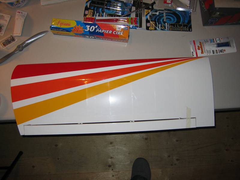

Old 03-02-2007 | 02:32 PM
Joined: Feb 2007
Posts: 63
From: st-sauveur, QC, CANADA
Default RE: installing ailerons on a alpha 40
check it out and let me know what you guys think of that, this aileron came out of the box with a curve on the side where it needs to attach to the trailing edge of the wing. I allready glued the shaft that goes in the aileron with 5 min epoxy and i am about to glue the inges in place.
should i go on like this or get a new aileron? Am i to picky?
thank
