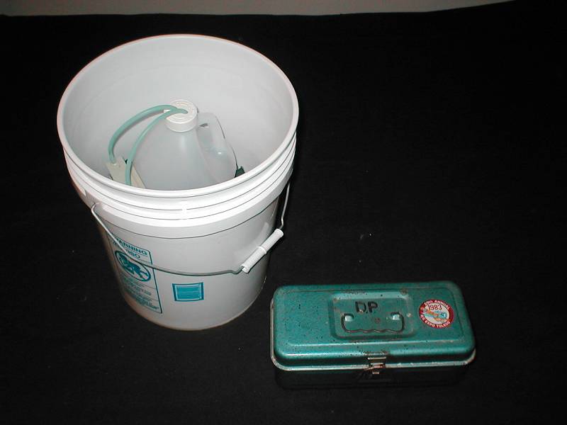

Nice flight tote Tigerdude!

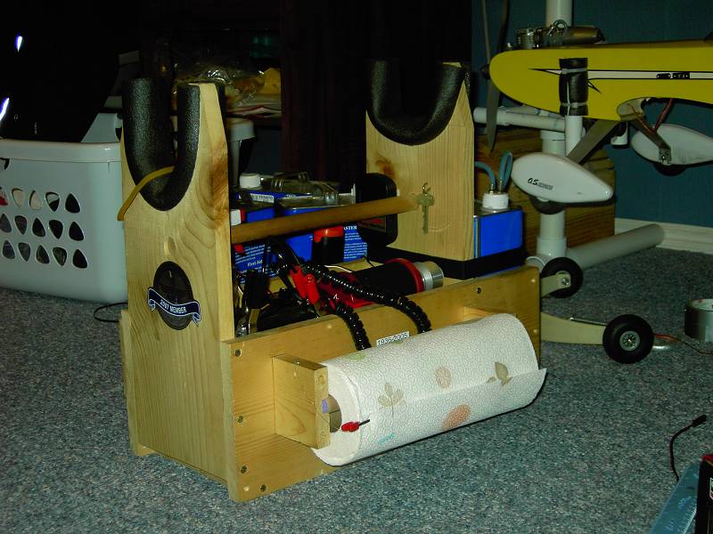

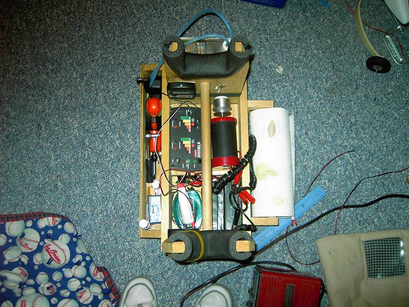

Mine has a handle instead of wheels to haul fuel, electric starter, 12 v battery, paper towels and whatever. Plus a tool box for everything else I need.

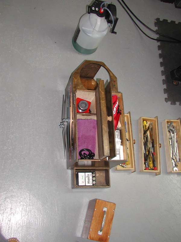

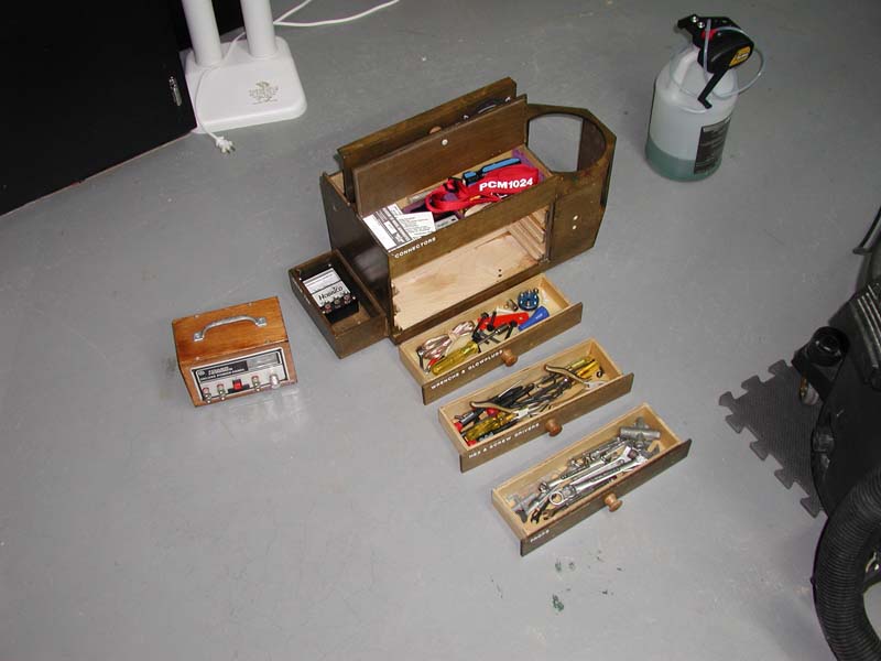

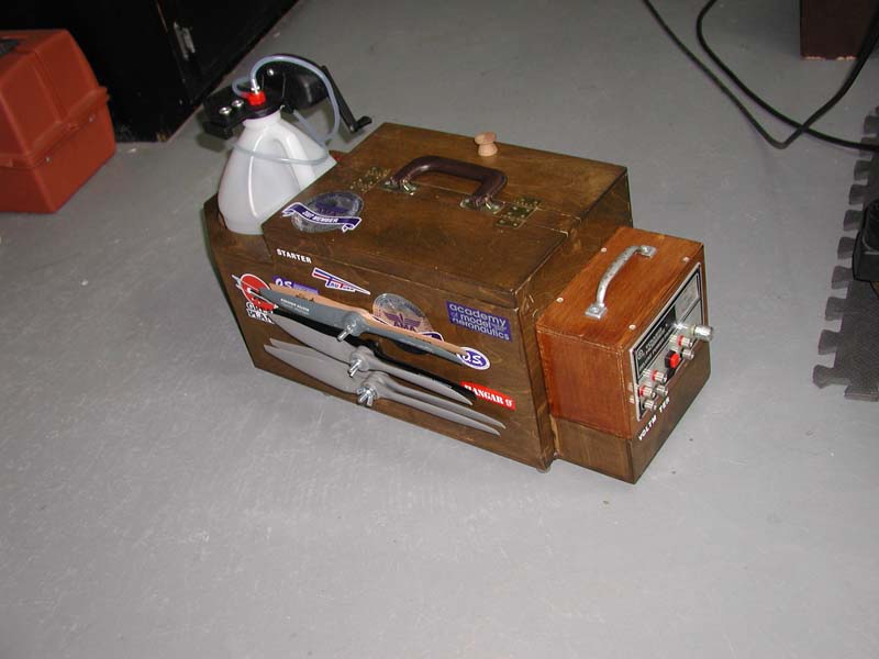

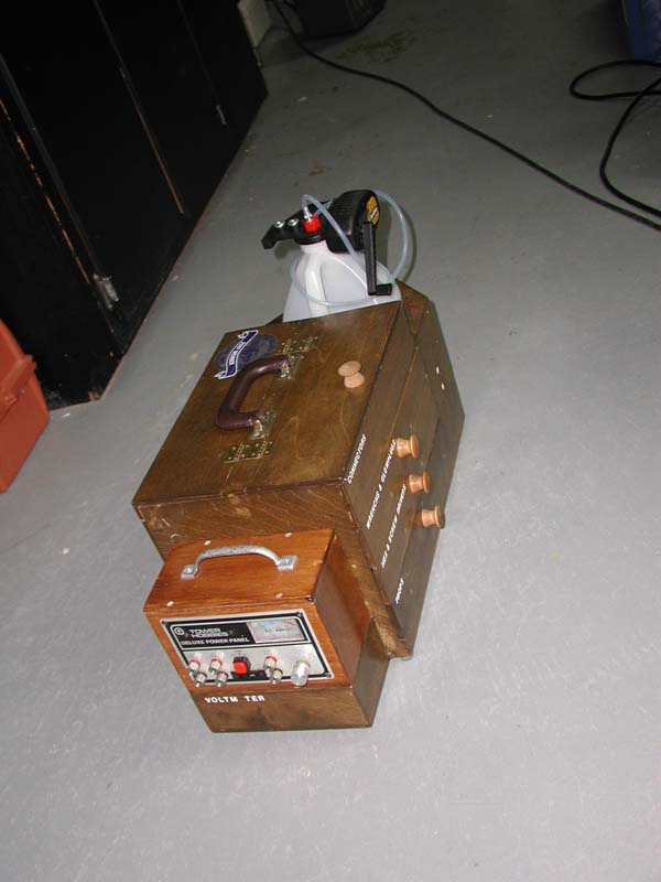

Here's mine. Complete with motorbike battery, paper towel dispenser, model airplane saddle/stand, tool pocket on side, fuel can section, two level main section, and of course AMA stickers.
This box is totally home made and designed by me. The cool part is that I am able to just keep adding different things to it. Originally it had no side pocket, no paper towel holder, no airplane saddle, and the fuel can was on the inside instead of the outside. It has its problems, and is not nearly as cool as yours, but mine gets the job done.

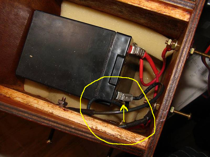

Very nice box Tiger, however I would caution you with the battery setup you have. The binding terminlas are exposed on the inside very close to your battery terminals. If they come in contact with each other (pos- neg) it could be an exciting afternoon. The previous advice to add an inline fuse is a good one. Just remove the RED terminal (positive) from the battery and solder or crimp in the inline fuse holder and re-connect. These can be purchased from Radio shack for a few dollars. I would use something like a 10- 15 amp fuse.

With me being advised to keep the terminals connected to the battery couldn't I simply wrap electrical tape around where the battery terminals are so none of the connections are exposed?
What does a inline fuse look like so I know what to look for when I shop for it? Can someone provide a photo or graph or web-link of one for me? I would want the solderless kind please. I am using 14amp wire so I would go with the 14-15amp range inline fuse.

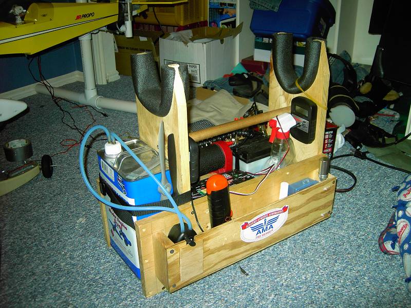

Here is my field box. I vaguely remember drawing plans for it, but couldn’t say where they are now. That was 16 years and three moves ago. I am sure I didn’t do real detail drawings though. Most of it I just created as I built. The whole thing is out of Finland Birch plywood. I was a sales rep for an importer of the stuff at the time so it was a benefit. As you can see there is room for everything.

Yes, you can definitely do that. I looked at the picture again. Your battery is actually pretty secure in its foam. I doubt that it would ever move enough to touch anything, but there's nothing wrong with taping up for added protection.
