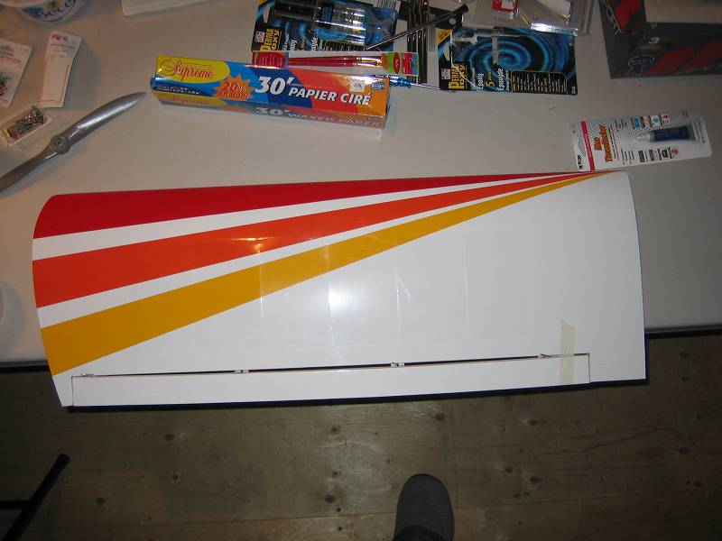

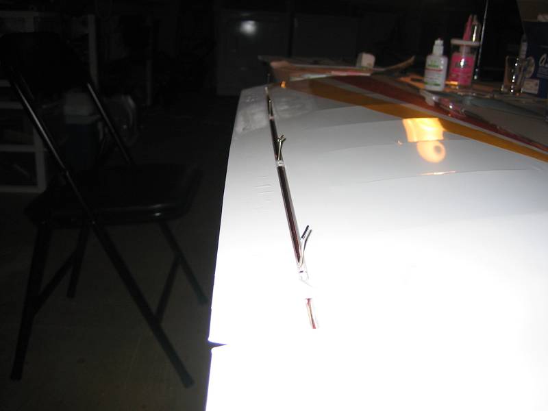

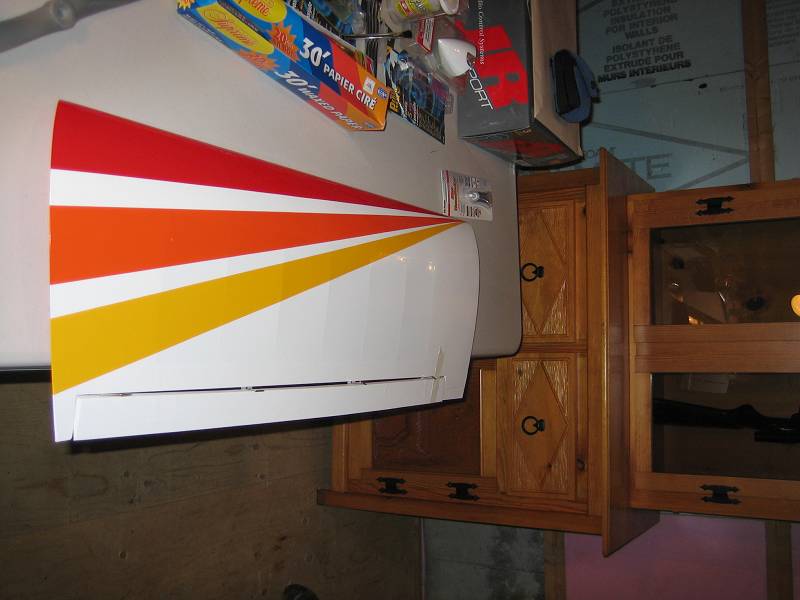

check it out and let me know what you guys think of that, this aileron came out of the box with a curve on the side where it needs to attach to the trailing edge of the wing. I allready glued the shaft that goes in the aileron with 5 min epoxy and i am about to glue the inges in place.
should i go on like this or get a new aileron? Am i to picky?
thanks
Marc-André

I would contact the manufacturer and ask for a new one and shaft. Using that one is asking for flutter and, indirectly, a crash.

That is not acceptable for me.
Send the manufacture an e-mail with the pictures, have them send you a new one.

This is ONE of the reasons for test fitting several times BEFORE applying glue. Once glue is applied it complicates things.
I assume you are calling the aileron torque rod the "shaft"??
Did you use epoxy on the torque rod? If you have a covering iron (household iron in a pinch) heat up the area near the torque rod and it MAY soften the epoxy enough to remove the aileron. Use a twisting motion instead of a pulling motion as soon as able.
Check the aileron and the wing trailing edge with a reliable straight edge to see which one is crooked. Perhaps both.

it's only the aileron that is crooked...
but yes i should of think of that before applying the glue.
i dont think i have any room to fit some kind of iron there.
what about the CA debonder?

A CA debonder won't have any effect on epoxy. Heating it is really your only option. I would just ask the manufacturer to give you another one as well.

That is a pretty big gap, but I have seen airplanes fly with worse. I think what I would do, since you have already epoxied the torque rod into the aileron, is to go ahead and CA the hinges in and then seal the hinge gap with some clear tape.
To seal the gap, here's what you do. Get some clear tape that is at least 1" wide (like packing tape) and cut a piece as long as the aileron. Now set the wing upside down and flex the aileron downward as far as it can. Then carefully fold the tape lengthwise with the sticky side out (it doesn't have to be actually creased, but bent as much as convenient). Now the tricky part. You will stick the tape down into the gap between the aileron and the wing. Try to work it as far as you can down in the gap. A small screwdriver and/or a popsicle stick will help push it down and make it stick. Might take a couple tries to get it in straight.
Don't despair, it can be done. Actually, it would probably work just as well to do the tape in 2 or three pieces.
You can do both the bottom and the top sides, but just the bottom is probably enough. You do the bottom because that's where it will show the least. Doing the top also will help keep dirt and fuel from loosening the tape.
When you got the tape in there good, flex the aileron back and forth to make sure it moves easily through it's full range.
If you want, you could use the Monokote trim sheet instead of clear tape. This has the advantage of being in different colors (although it will probably not exactly match your colors) and it also comes with adhesive on it with a paper backing. You can cut a long strip, fold it with a good crease, peel off the backing and stick it into the gap. Good luck!

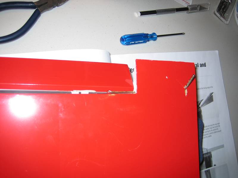

Default RE: crooked aileron on alpha 40 PLEASE HELP...
the rod or shaft that is epoxied is, i think, the same rod that comes out underneth the wing wich we get the rod to connect to.
This rod was just fit in a hole made by the manufacturer and epoxied it was not threaded in.
i'll give you a picture so we all talk the same language.

You are CORRECT, it is the same rod. A single piece of rod with bends on each end. It would be IMPOSSIBLE to remove from the wing without removing the small piece of wing at the center-rear of the wing. There may also be some form of "bearing", sometimes just a bit of tubing, inside that wooden area. To change the rod you would have to remove the wood piece, any "bearing", install new "bearing/rod assembly and reinstall the wood piece. You'd then have to repair the covering slightly.
Your best bet is to try to do this without changing the torque rod. There are many ways of removing the old epoxy from the torque rod if it comes to that.
