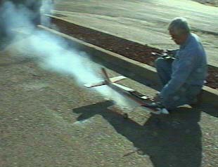

I don't know anything about putting brakes on a Trainer, or why. I do know of a fairly inexpensive yet effective pumpless smoke set up you can by for $30.00 that does work well with smaller glow engines.
http://www.macspro.com/smokesys.asp
Here's the link of the installation, (note that they have it mounted in an Avistar 40)
http://www.macspro.com/smkinst.asp
Finally here is the link of the smoke system in action. Not too bad really for a $30 smoke system.
http://www.macspro.com/videos.asp
I hope this answers your question for ya. Good Luck.
P.S. If you add this pipe, it is allready drilled & tapped in the right place & ready to accept their pumpless smoke system. You can do it this way with their pipe & smoke system for just under a $80.
http://www.macspro.com/onepiece.asp

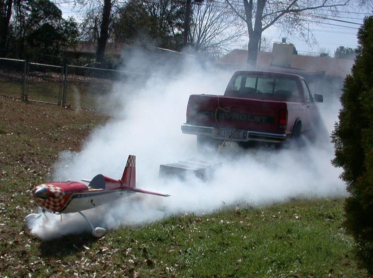

@elenasgrumpy
unfortunately in the air the smoke produced by a small glow engine is very lacking and you can hardly notice it. they just don't have the heat to vaporize the smoke oil so you end up with minimal smoke (like in the link you posted) and ALLOT of mess on the side of your plane. if you want smoke that you can see and smoke that sticks around a little bit a gasser (or a turbine) is the way to go and there is no comparison.........pic one is of the avistar w/ glow and Macs smoke......pic two is a gasser.
kc
kc
if you'll look close the truck is just there to tie the plane to with a rope to hold the tail, i also had to put a few 30mm ammo cans on the rope to keep the tail from lifting up.
kc

Another quick question... why would a small gasser like the G20 produce more smoke than a glow? Does it run hotter and therefore can vaporize the smoke oil better?

foosball, I believe that is the general concensus, however since I don't own a gasser I will let those with more experience in that field answer that question. I don't want to mis-inform you with incorrect information.
yes a gasser has an EGT (exhaust gas temp) of around 800-900 F, a glow is about half that and a turbine twice that. also the G20 will fit your 60 size trainer and will also fit allot of the Hanger 9 60 sized ARF warbirds as well as allot of the 60-90 sized kits
