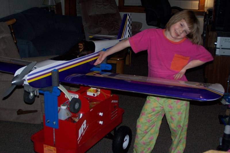

ps Nice plane! Is that your copilot showing it off?
