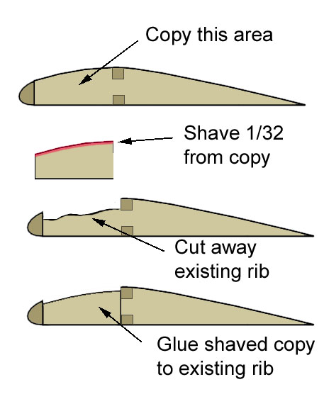

I am repairing a Spirit 2M glider. I read an article by Mark Drela on sheeting the outer wing panels to reduce or eliminate tip stalling. He calls for shaving 1/32" of the top of the ribs from the leading edge back to the spar. Before I get too carried away with my exacto I want to make sure I'm doing this right. 1/32" is not much. Any suggestions or tips before I start shaving and maybe shave too much? There isn't much room in there as the wing in already built. Thanks in advance.

I think they want you to take off the amount of rib surface that will EQUAL the "thickness" of the sheeting you want to apply. I am assuming that the sheeting is to be 1/32" thick balsa. Since it is a glider, I guess they are trying to minimize the added weight. I was building a 4* 120 and was going to sheet the wing in the same manner. That sheeting was 3/32" thick.

Thanks Bob. Yes the sheeting is 1/32". I hoping someone has a secret tip of shaving that much off the top of the rib without taking too much off or causing any other problems. Mike

If the wing's already built, you're probably either going to have to do it slowly by hand (which would be a pain), or make a jig for it. Get a small piece of tin, copper, or aluminum, like the sheet metal from a heating duct, and shape it so that you can hold it against the bottom of the rib and the top will leave 1/32" exposed, then you can trim it getting all of them the same.
If you've got the plans for the plane, this shouldn't be too hard to do. It is a pain getting the metal and messing with it, but it will give you a template so that you do them all the same and end up with a smooth LE all the way down the wing.
Just thinking out loud here, this advice assumes a constant cord wing, which I don't think sailplanes usually have. You might have to trace the outline of the top of the rib and cut a piece to match that outline, and then glue two 1/32" guides to each end. Then you can hold the guides flush with the top of the rib and cut along the outline, which would only leave to small 'tabs' to cut off of each end when you raise the template. Did that make sense?

Another way to go is to make balsa copies of all of the rib fronts, and shave 1/32 off of the tops. Then remove the tops of the existing ribs, and glue the copies along side them.

Excellent idea! Hadn't thought about it not mattering if the tops were shifted over a little.

Thanks to all for the suggestions/tips. I think MinnFlyer has given me a method I can handle. At least this way if I cut too much off the copy, I can just make another copy till I get it right! That is a great drawing too. Didn't know Photoshop could do all that. Thanks again! Mike
