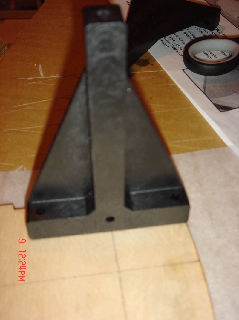

Hi , I am new to this hobby and building my first kit. I ran into a problem and would appriciate some help on clearfying the following
I am trying to figure out the exact placement for the engine mounts on the firewall. The kit came with 2 glass filed mounts and the diagram said to mark the center line and the thrust line on the firewall but it does say if the mount needs to to alligned with the thrust line. I have an OS 40LA engine. Does the thrust line have to rn through the center of the engine? does the center of the mount have to be alligned with the thrust line?

Yes. Those line must line up in the center of the engine. CLamp the engine to the mounts or use Thin CA to hold it on and place that engine right in the center of those lines.

the kit i built had alignment marks on the mount itself and said to align the cross marks with that line,unless you are goint to mount the engine diagonally use those marks.

there are 2 lines on the mount which one shall i use and do i align it with the thrust line ?

Yes, use both those lines. Those lines are there to help get the engine and the mounts in the correct position. The 4* already has thrust built into the airframe so you do not have to figuer that out for yourself. You will actually make a cross with the lines and you put the engine right in the middle of the lines. Let me just say though that the plane is such a forgiving plane you can be off a bit and it will still fly nice.

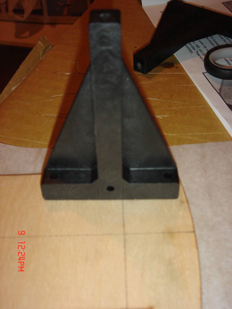

Hi
I took a couple of pic to clarify my confusion, you will note that in one picture i have placed the mount with the thrust line right inbetween the two lines on the mount and in the second the thrust line is alligned with one of the lines on the mount. Are either one of these the correct position or am I totally off the track.

Old 04-08-2007 | 12:01 PM
Joined: Apr 2005
Posts: 286
From: Southbury CT
Default RE: Sig four*40 kit
My friend you are doing great. The first picture on the left looks just right.
Old 04-08-2007 | 12:12 PM
Posts: 3,282
From: Bloomington, MN
The thrust line is where the prop shaft will be. That's the center of it.
Old 04-09-2007 | 01:53 AM
Joined: Feb 2006
Posts: 4,465
From: Arroyo Grande, CA
Ditto the one on the left. In all engines that I know of, the bottom of the mounting lugs is dead on center to the crank shaft. So, placing the top of the moter mound on the thrust line is correct. Just like shown on the left photo.
