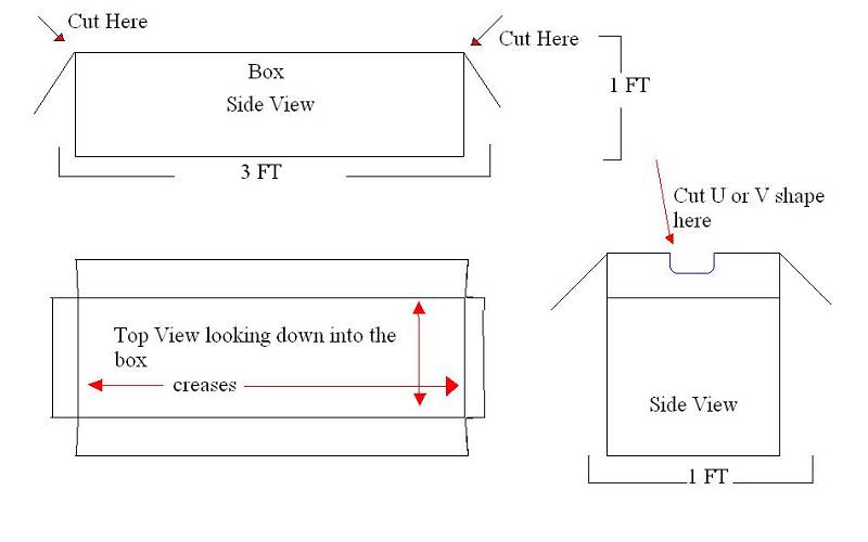

I did an idea like the foam cooler, only you can't put too much weight on it or it will ruin the design. I took a decent sized cardboard box that was approx. 3ft long, 1f wide and about 1ft tall. I folded the (tabs, lids, whatever you call the top of the cardboard that you use to close it up) too the outside and cut a U shape into one of the long sides and a V into the other. The U-shape holds the engine cowl area and the V-shape holds the fuse near the tail. Since I am looking to sell the plane soon I didn't want to shape PVC or similar for it...maybe I could sell it with the plane...hmm.. anyways..this is a cheap idea for the bargain hunter and I don't recommend it for heavier models. Heres a pic..I hope you all get the idea with my beginner art...

This idea came from one of the model mag's. some year ago. It's a combination of the
card board box and styrofoam. Take a box and cut the top end tabs off leave the side
tabs on and fold them inside the box. Glue a 2" thick piece of styrofoam to the inside
end of the box big enough to cover all of the box end. Then cut the styrofoam in the
end of the box to the shape you like to fit your plane. I have several of these they work
good both for transporting and working on the bench. Cheap too.
