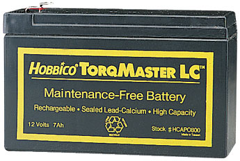

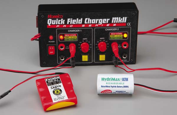

Hi all,
so I can fly on one batteries pack 500 mAh about 3-4 safe flights? I just want to fly more without wondering if there is enough power up there.
is the setting in the picture works?
Can this charger in the picture to charge Rx batteries between flights from a 12V cell? Or there is a better way to do it?
Are these hydrimax any good for 10 flights?
its just after the Field box discussion is this the right panel?
Alex

yes it will work ok.
If you're thinking of changing batteries at the field ,to fly more. I wouldnt . the battery pack is a big part of weight and balance.
Use the field charger instead.
10 flights will be a chore

Yes, the charger will work. Another option is to buy NiMH battery packs instead of NiCad. You can buy a NiMH pack that will provide over 2000 mah and will be the same size as the 500 mah NiCad pack.

Your TX charger will work, you just need to let it charge MUCH longer.

I have one JR charger that outputs at 150mA for the TX connector.
For the larger packs a higher output will be better, but you do not want to over do it too.

The 2000mah Rx Nimh pack is a good suggestion. You want to be able to charge it at arount 150 - 200ma's.
Another advantage of Nimh over NiCd is the metal hydride cells do not develop a memory like nicads do.
