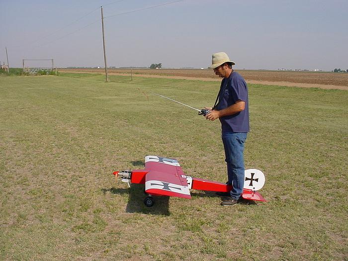

You can't beat a stick.
Giant Big Stick MDS 2.18

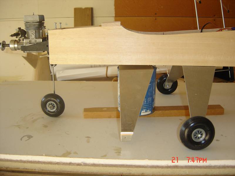

Obviously, you will have to add a tail wheel.
My plans simply show two locations for the aluminum legs. All you have to do is reposition the gear forward of the CG. I can check the precise location if you need me to. You may also have to add some ply bracing inside fuse to support the gear. IF yours is the ARF version, it may already be beefed up. I'm not familiar with them.

Here are the options GP showed on their kit. For a tail dragger, the distance from the front of the firewall to the front edge of the landing gear was 7 3/32.

THANKS FOR THE REPLY!!!! This answered my question...
